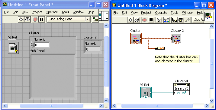

3) Strangely, the use case of putting the subpanel in a cluster was considered important, without changing the type of the cluster... I didn't really think this would work, but I drew the VI pictured below in LV 8.6. Weird... I've never seen a subpanel in a cluster control, but apparently we thought everyone would be doing that someday.
So, there you go.
Intaris
Proven Zealot
Subpanel in a cluster???
Is it possible to DO anything with it if it doesn't show up in the Unbundle?  Right-click on the FP and create property node?
Interesting.  If we do this does the content of the Subpanel get propagated on the wire with the cluster?
Shane.

You can't create an array of SubPanels, but you can create an array of clusters, and you can put a SubPanel in a cluster, so...
We need the SubPanel to show up as a terminal inside the cluster so that we can create a grid of DYNAMIC INSTANCES of a SubPanel! (Related to the venerable Array of Graphs hack)
