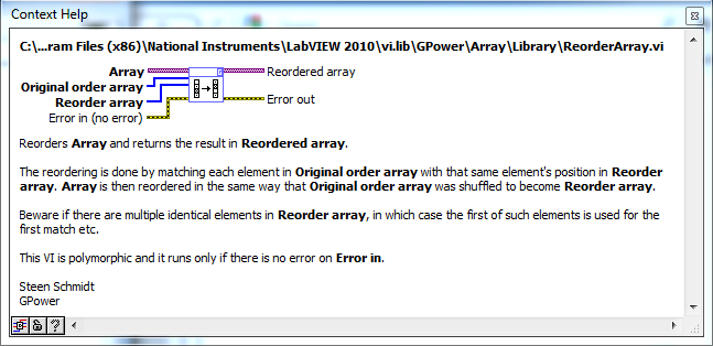

@JKSH: No, I wouldn't want to completely override a built-in error code. But I often append a description to an existing error code - for instance error code 1 which means invalid input parameter. There are many cases were an error is due to an invalid input parameter. In the GPower Array toolset the ReorderArray function can output error code 1 with an additional description for instance:
ReorderArray context help:
undefined
Example error explanation:
undefined
