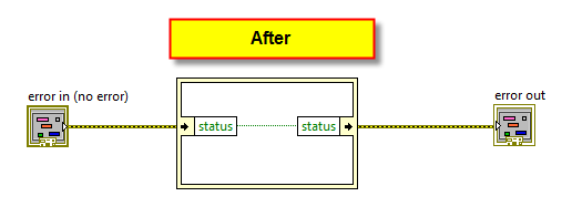

I wish there were an easier way to insert an IPE Structure onto a wire.
For example, I'd like to right click on a cluster and insert an IPE Structure and have it automagically add the IPE with Unbudle/Bundle nodes.
This would make sense for Arrays, too (adding Index/Replace nodes).
Maybe someone want's to create a plugin for the JKI Right-Click Framework that does this 😉

Yep, I like it. I would be happy if, instead of the Add option, it just worked when you drag an In-Place structure over a wire. As it is now, I have to delete the tunnels it makes, then add the In/Outs, then wire it up .

Also, when you left click a cluster or a data reference, for example, you could tell Labview "use as unbundle", or "read value reference" and just like shift register, ask where is the other part, "bundle", or "write" in my example.

I just tried this in LabVIEW 2025 Q1 and there is a right-click > Insert > In Place Element Structure menu item for both cluster and array wires. I don't remember hearing about this getting implemented, but it looks like it was at some point?
crossrulz
Knight of NI
It is there as far back as 2020SP1. I don't have an older version currently installed to test.
