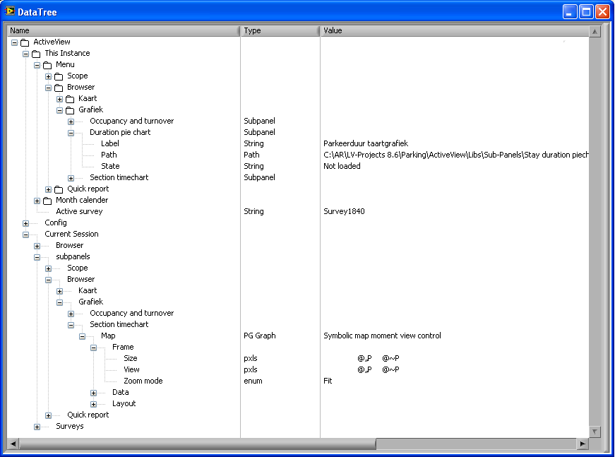

I have been busy for some time to define my own kind of datastructure that combines some common stuff into something I think is almost an ultimate memory structure...
It is tightly integrated to a lot of stuff I made so I cannot provide a simple example but here is some outline... The idea is to have a tree as a basic structure that combines the ease of pointers in C, combining paths like in a file-folder structure, read-ability (with the correct tools) as an XML document, the possibility to dump/import/move/copy subsection of the tree and the freedom of an ini-file.
The concept is a tree where instead of pointers as in C labels for each node are used. Each node can have children that can be a subtree or contain items. Each item has 3 properties: a name, a type description and a value. Any item in the tree can be accessed by it's name and names can be combined as if they are a path. Of course all functions that you would normally expect from a tree are availiable.
I have added some additional cherries such as events that are generated when items change so you do not need to poll. I am still busy developing this concept further but I intended it as a way to handle large and flexible datastructures in a parallel programming way.
If there is serious interest in this concept I will see if I can free up some time to make it possible to be used outside my own stuff. The current implementation is based on the LV tree control.
The picture shows a screendump of the debug window that contains some physical data.

Before you proceed with this, you might want to check out some of the implementations people have already put out there. You could start by looking at the Lapdog group on this site and by searching the LAVA forums for things like "tree", "linked list", "structure", etc.
On a side note, the sentence "The current implementation is based on the LV tree control" is a red flag - the tree VIs are meant for a UI control and as far as I know are pretty slow and not something you should build on.

I know the UI tree is a big red flag 😉 altough I am suprised how fast it actually works as long as the display isn't open. I have made the architecture such that I can replace this UI element by a faster implementation in the future.
At this moment I am mainly looking to stuff such as 'how to interface this with code in such a way that it is easy' and the event handling structure.
Thanks for the LAVA tip, I will see if there is something I can use for a better implementation.
