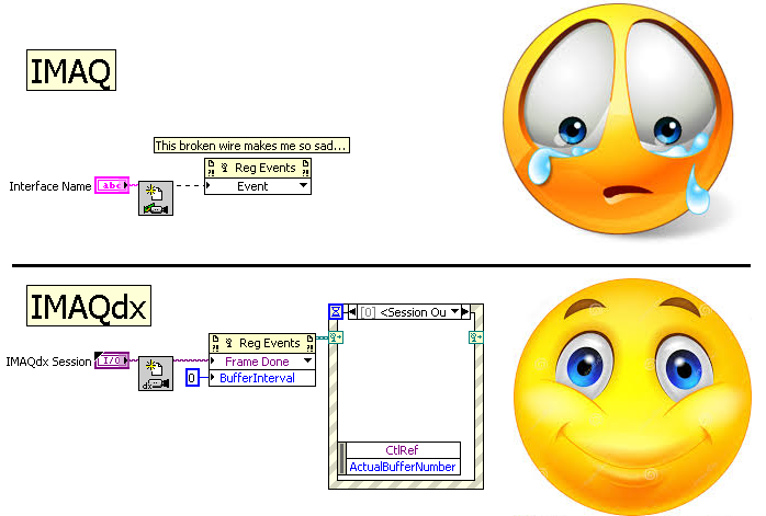

Events are great, it would be great if they could be implemented into IMAQ like they are into IMAQdx.

I don't have IMAQ or IMAQdx so I might be missing something, however this document states: http://digital.ni.com/public.nsf/allkb/0564022DAFF513D2862579490057D42E
> The NI-IMAQ driver software supports National Instruments hardware only and is needed to use the following image acquisition devices...
> The NI-IMAQdx driver software is needed to use third-party image acquisition devices which use the following buses and standards...
So NI driver support lacks functionality that third-party support provides?
