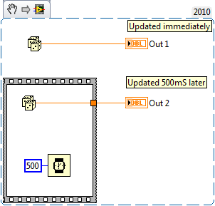

When you inline a subVI it is not the same thing as placing the contents of the VI on the callers block diagram. Almost but not quite.
The difference is that all outputs of a VI (inlined or not) become available at the same time when the VI completes execution.
Set the VI above to inlined and use it in another VI
The idea is an additional inline setting as follows.
Now the VI will truely be inlined as if it were not a sub VI at all.
The name "hard inline" is just a suggestion and could be called something else.

We discussed this idea when we were creating inlining. Let me give you our reason for not doing it and let you guys debate it. It's the sort of thing we could easily revisit.
Since the node looks like a subVI, anyone reading the diagram is going to expect it to behave like a subVI. It shouldn't matter to a user how the node is implmented, and inlined or not is an implementation detail. Therefore, we want to do the inlining with the same synchronization barrier for results that a regular subVI would have. Although it is true that many configuration options on a subVI can affect its call behavior, for the most part, things like which thread it runs in or whether it is reentrant or not are of no concer to the caller, so long as the subVI does the job it is documented to do. This would have introduced a change of behavior that seemed, to us, to be non-VI-like behavior.
Moreover, you could imagine a subVI being written such that it acquires a Semaphore in one independent branch, with some other code in parallel, and it would be unexpected, from the point of view of someone reading the diagram, to expect that the two branches wouldn't both be finished before the code proceeded. Common use case? No, but it would be very odd.
Combine that logic with the fact that subVIs with truly independent outputs are rare, and it seemed like synchronizing the outputs was the right choice.
What are your counterarugments?

I agree that hard inlining would open a can of worms that would make code very unpredictable and hard to read and debug.
(In this particlular example, you simply would make two inlined subVIs instead, one with the fast and one with the slow code.)

You are right that independent outputs are rare. One use case that I should have mentioned is that with this feature it would be possible to update an indicator on the caller using a wire instead of a reference. I just have it in my head that this feature could be useful to me someday.
Yes it is non-VI-like behaviour. But it seems reasonable that an inlined VI would behave differently. I would expect an inlined VI to behave just as if I copied it's code to my block diagram.
Yet I totally understand that it could be unexpected and weird to someone who didn't write the VI.

I'd vote for inlining itself behaving like true inline expansion, thus an extra level of "Hard inlining" not being necessary. I.e. inlining quite concretely replacing the subVI with its contained code for compilation.
The only minor drawback I see is the one pointed out; that inline expansion would make for some interesting twists with execution highlighting enabled for instance - here's suddenly a "subVI" that runs as soon as one of its inputs are ready, and which will return output possibly asynchronously. But I think it's a matter of getting used to this behaviour just as with reentrancy etc. Will this really be more puzzling for a LV-beginner than seeing the "waiting" glyph on a non-reentrant VI that is executing somewhere else?

> True inline expansion ought to allow for higher compile optimization at least?
No. What is inlined is the code before the optimization pass. The optimziations are still applied.
> True inline expansion is what I'd expect when the feature is called inline.
I'm not sure that I communicated what's happening correctly... the code is inlined, as in, its code is indeed copied to the caller diagram. But a sequence structure is placed around that code. When I talked about "synchronization", this was not synchronization between calls to the same subVI, but just synchronization of the outputs. Some of your comments make it sound like you thought I was talking about synch between calls to the same subVI.
Here's a VI that would have serious problems if it were inlined and we *didn't* put the synchronization in play. The Semaphore Acquire has no data dependencies on the two VI inputs, so if you inlined it, it would immediately acquire the semaphore long before the subVI was ready to execute.

Steve,  reducing the overhead of a inline call by even removing the phantom sequence structure' tunnels sound great, but certainly breaks the data flow paradigm of "all outputs from a structure are available at the structure's completion." There is functionallity in LabVIEW to support dynamic data availability from co-rerelated-but-non-synchronous (if that term is not oxymorononic) computations simialar to your argument that it would take a larger BD.  The navagation window!  while not easy to take, if you must have one output available before another they necessarilly lack the cohesion implied by a sub-vi.  NICE discussion though-  I could be persuaded- but you need a specific cohesieve example that cannot be worked around to get me off the fence.  I encourage you to try to get me off the fence!!!!

I have to confess that i am, even though i find this suggestion interesting, against it. AristosQueue did already explain it in a very good way: If "true inlining" would be used, the very basic functionality of LV would be broken:
A node is executed if all inputs carry valid values, and a node will return on all of its outputs valid values if it finishes execution.
So as already pointed out, "true inlining" would reduce maintainability from the calling VI since there is obviously a node (the subVI) but it does not behave like a node.
There is one "node" 'misbehaving' like that: Flat sequence structure. And there have been quite some confusions on this structure resulting for instance in race conditions.
To quote DFGray from here:
"If it is not rock simple, a new user will not see it".
Transferring it to this topic: If it is not behaving like a normal subVI, new users will either never use it or (this would be the problem) simply misusing it, creating race conditions and alike.
