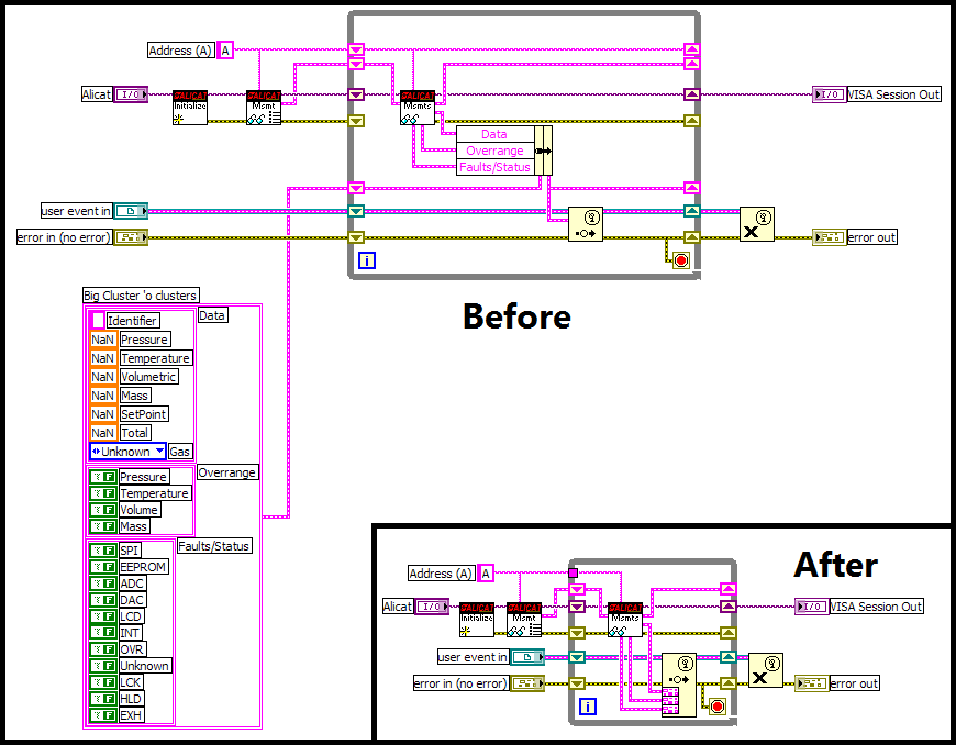

I'm going to go ahead and respond about the location of the Error lines - they need to maintain correct spacing with respect to the reference to fit the standard 4-in-4-out Connector Pane.
I realized that while creating a mock up here. I've copied the two images below, illustrating how dramatic the improvement can be:
