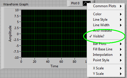

What about just a context menu? I like the idea of toggling visibility easily, but I don't like muddying up the Plot Legend:

Why not ! I just suggest one way to access property easily in graph control, but menu it's also ok 🙂
but it has to be in the right place in the menu because I believe that the common user that didn't know good LV graph is not using easily context menu (right click is really a computer scientist reflex !)

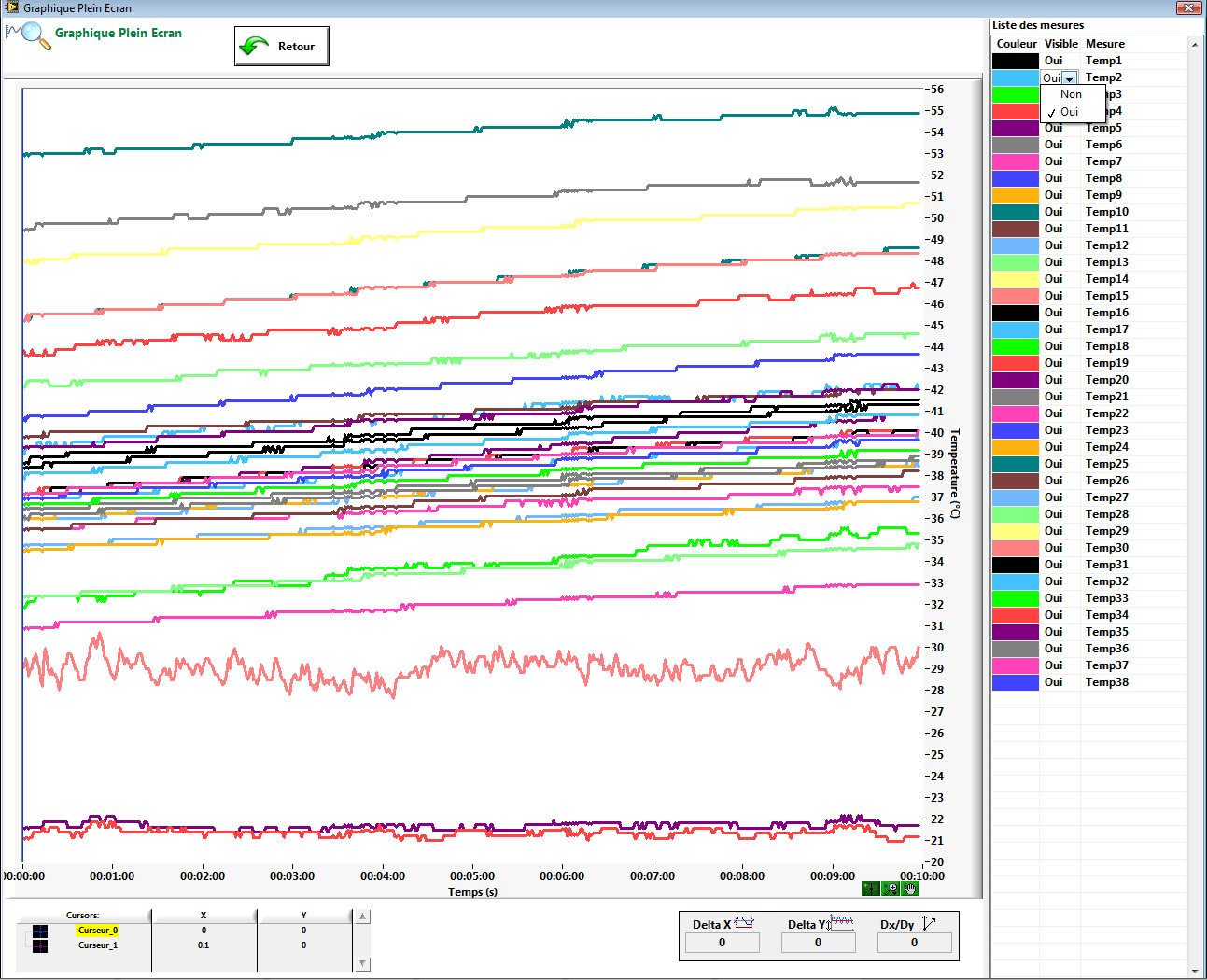

Thanks for your support IanW, I devellop myself some type sensitive dynamic cell popup  (based on TSPopup librairie from LAVA) to make my self plot legend list and properties in a multicolumn listbox.
Something like that ...
Type sensitive Graph properties
