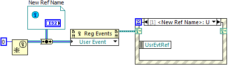

Sorry for the link to the beta forum. That was my workaround to this forum not letting my update an arbitrary file. Let's try a different approach. Below is an image with an embedded diagram. You should be able to drag this image to your LabVIEW 2009 diagram and get the node. If it doesn't work from the browser, try saving the image locally and dragging the png file to your diagram.

Bingo. Would you consider including this in the LV Base Package under the Conversion or Data Manipulation palette? This function has strong overtones as a solution to altenbach's A universal conversion bullet. For that solution, rather than the input, maybe a polymorphic selector?
GregR
Active Participant
Personally, yes I would like to see it exposed in the palettes. I'll see if I can get it in the next release.
JackDunaway
Trusted Enthusiast
Make it an idea, I'll vote. That is much safer than my current method that I have used numerous times.

I really like GregR's Coerce to Type function.  I've saved a Snippet of it on my desktop so I can paste it into my code where needed.  Is it possible to post instructions to tell us how to add it to the Function Palette (as a User Function or AddOn), and/or how to make it accessible with QuickDrop?  This is much too useful to leave "flopping in the breeze" -- it needs to be made an (optional, perhaps) part of the LabVIEW Function palette.
Darin.K
Trusted Enthusiast
1. Create a New Sub VI
2. Drag the snippet to the BD
3. Select the node and copy to clipboard
4. Edit the Icon, clear the default icon and then paste the node image
5.  Save the VI with the name 'Coerce to Type'  This could be in user.lib if you like so it just shows up.
6.  Edit the palettes, add the VI if you did not save it to user.lib
7.  Go to the VI in the palettes, right-click and select option to place VI contents.
8.  Save changes.
There is a QD shortcut to add selected code to the palettes, but I would go the long way to get the cool icon.
