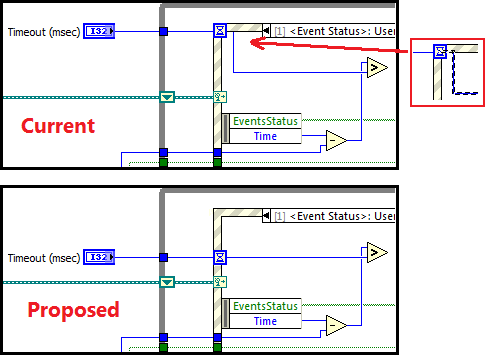

Allow Timeout Terminal on Event Structures to Move
Status: New
Sometimes, it would be handier to have the timeout terminal move along left side of the Event Structure, not tied to the top-left corner. Also, when you wire internally to this terminal, the wire is obscured by the top of the Event Structure border (where did that mysterious wire come from?? Double-click to highlight... oh, the timeout terminal)
undefined
For completeness, I think this idea should also be applied to the Count Terminal of For Loops. (You might consider it a companion - or the opposite! - of the Option to Show/Hide the Iteration and Count Terminals of For Loop).
Oh, and certainly, if this terminal can move, make the structure corners non-magnetic!!! Smiley Very Happy

That does seem to be a design flaw of the location of the timeout node.  I never noticed before because I rarely have needed the timeout value within the event case.  I wouldn't want to move the timeout value too far from the corner.
This got me thinking.  Suppose the wire left from the corner of the timeout node?

Also, I never noticed the flaw until today either. It's not very often that I wired the Timeout value from the inside of the terminal (I think today was the first time ever?), but it hit me when I noticed the flaw... it sure would be nice to move this thing around, and would allow cleaner code in many other places.

I don't think I would want the timeout terminal to move, because I already have a problem with the walls of event structures being too crowded (data terminals, dynamic events, tunnels, etc.). I didn't even know you could wire to the inside of the timeout terminal, and whenever I needed the value, I passed it in through a separate tunnel.

I often find myself using the timeout value inside an event case and always thought it odd that you had to create a hidden wire to make the connection.  If not movable, perhaps its permanent location should be far enough down from the upper left corner to allow a wire to pass across the structure without being hidden by the event description.  At least nothing is in the way of connecting to N in a for loop.
