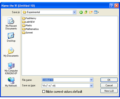

I have done it again!  Every so often I get a VI running just the way I like it, save it (back it up as well), but when I go to use it the next time, all of my carefully chosen control values are gone.   Having seen similar problems on the forum (in both questions and answers), I am not the only one.  There is by default no keyboard shortcut to 'Make current values default', I have changed Ctrl-D (default) to do it so I usually go Ctrl-D Ctrl-S.  (Ctrl-D is set to do something else, I forget what, but I never used that shortcut anyway).  I suggest a modest change to the save dialog to add a little checkbox option (default unchecked) to 'Make current values default'.  A gentle reminder the first time we save a VI.

I agree... that has been an asschapper for me in the past also. I just don't know if I agree with the suggested implementation. The main reason is this: I never use the blanket "set all values as default", but instead carefully select which FP objects I actually want to set the current value on.
Just throwing this idea out, not saying I agree with it, but maybe it can spark discussion: If a FP object has previously been set to a non-NULL default value, the save dialog gives a gentle reminder if the current value differs from the previously set value. The reminder would list the labels of the FP objects, and you could have the option to "Set as Default and Save" or "Discard and Save".

I am open to all implementation suggestions, I'd just like to see something.  I figure that you see this option when you are saving a VI for the first time, or doing a Save As.., both times you are likely to have tweaked FP values.  If you don't want to check the option, at least you are reminded to go back and check your default values.  I agree that if I did a test run and dropped a million values into my chart I probably wouldn't like that to be the default.
I really hate when I do this with a sub-VI and then don't wire the connector since I assume the default value is set to something I like.

The problem with the save dialog option is that very often I use Ctrl+S or  Ctrl+Shift+S to save.
