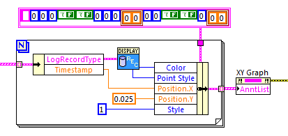

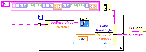

Another comment: I would prefer a typedef on the cluster, rather than a typedef on the array of that cluster. I have found it a better programming practice to not typedef an array, but instead the array type.
For instance, here's the current method. The typedef'd array is on top, and I dynamically build each annotation, then Auto-Index them out of the loop and into the Annotation List property. I have two problems: I need to index the typedef to get a single element as the basis each annotation, and I have a coercion dot on the Property Node because the array is not typedef'd anymore:
If the "Annotation" cluster were typedef'd rather than the "Annotation List" array of clusters, the code would be cleaner:
The reason I bring this up is important: it is the segway into the new typedef. The old Annotation List (and Cursor List) array typedefs should be held onto for a year or two then deprecated, and the new typedef'd cluster should be phased in.
