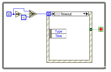

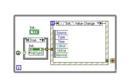

if you want do something from the start of event structure, you can creat a dynamique registration event a fire it immediatelly ,like in diagram below.
It will be handy to put on it the initialisation actions and like that minimise the size of diagram.
I like if there is one even "first run" on even structure (first run or first iteration).
