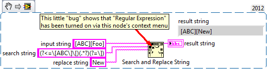

@JackDunaway wrote:
Looks like nothing a couple lookarounds as zero-width assertions can't handle.
Try (?<=\[ABC\]\[)(.*?)(?=\]) with the Search and Replace String Node, ensuring to turn on Regular Expression matching via it's right-click menu option.
One deficiency of Lookbehinds is the inability to declare a variable-width match. (Lookaheads, on the other hand, allow variable-width matches)
Notice in the quoted snippet, the lookbehind is looking for a fixed-width match -- [ABC][
What happens, for instance, if our application domain does not allow us to constrain the lookbehind as fixed-width?
Try replacing the Lookbehind with the escape sequence \K which excludes everything preceding from the whole match.
The original regex (?<=\[ABC\]\[)(.*?)(?=\]) could be rewritten as \[ABC\]\[\K(.*?)(?=\])
To make that original regex even more powerful for matching any arbitrary variable-width value inside the initial braces, we could write this as: \[.*?\]\[\K(.*?)(?=\])
And to take it one step futher if necessary, add a capturing group to grab the arbitrary value inside the initial braces: \[(.*?\)]\[\K(.*?)(?=\])
\K is great for excluding all matches prior from the whole match, while still allowing capturing subgroups to be returned as submatches.
