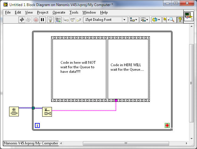

Here's a newbie mistake:
When wiring to a sequence structure with multiple frames in order to create data dependency, be careful which frame you wire to.....
Following code shows a construct which lead to a deadlock in my code because the first frame of the sequence does NOT wait for the dequeue primitive......  This is actually something I never knew.  If I place an "Acquire semaphore" in here.... 😞
Shane.
I talked about this weirdness long, long ago in this nugget.

Duly kudo'd.  After programming LV for so long and dealing with forcing data dependency between structures, I never thought of even looking up the help on this because it was so obvious to me that it would work as I *thought" it should.
So another day, another thing learned.

It helps to imagine a multiframe flat sequence as a sequence of individual single frame sequences, connected in the right order by by a data depedency.

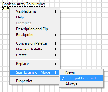

@JÞB wrote:
(LabVIEW Minutea that might bite you some day:  Float to int retains sign) seen here
On a related note:
I'm pretty sure I looked through the help.... I did not find a suitable explaination for this Right Click option ....
It seems like minutia that will bite visciously if angered.
Has anyone trained this dog to do tricks?
"Should be" isn't "Is" -Jay
