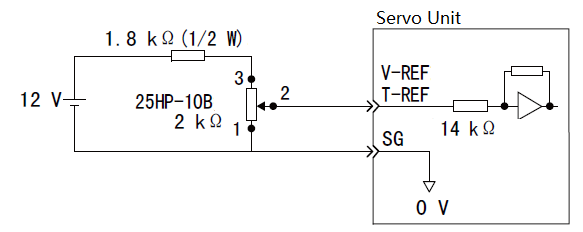

The myRIO has 4 AO channels which range between 0V and 5V on A/B-Port and 2 AO channels which range between -10V and 10V on C-Port . So if required highest analog input is within the AO range, myRIO can be connected to the corresponding parallel port of the servo drive directly. In the above case, user can directly connect available myRIO AO channel to V-REF/T-REF port of servo unit and AGND channel to SG port without extra circuit. But a booster circuit should be added between myRIO and the servo drive when the required input is beyond the output range of myRIO AO channel.

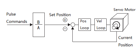

The above figure shows the working principle of position control. Position control is one of the main control modes for servo drive control. When working in position control mode, the servo unit receives a certain number of pulses as command signal from controller and drives the motor to certain position. There should exist a formula between the angle of rotation of the motor and the number of received pulses. Users can use the PWM function of myRIO for pulse commands generation. The PWM Express VI in LabVIEW myRIO can help users set the duty cycle and frequency of PWM. By setting different frequency, user can control the velocity of the servo motor when the servo unit works in position control mode. The frequency of PWM that myRIO can generate is discrete while 40HZ being the minimum frequency. But due to the on-off time delay of PWM, it’s difficult for myRIO to generate precise amount of pulses during specified time via its PWM function. So if myRIO is used for precise position control of the servo motor, close-loop feedback control should be used.

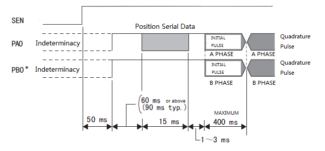

The encoder on myRIO can receive two types of signal: quadrature phase signal and step signal with direction. Generally the servo unit may transmit the data of servo motor encoder by quadrature phase signal via specific port. There’s no problem for encoder on myRIO analyzing the motor data if the specific port of servo unit always transmits the same type signal. But some servo drives may not act like that. For example, the SGDV Servo Drive may transmit its motor’s initial position information in serial data format firstly and then quadrature signal when servo motor works normally. The two figures above shows its data transmission sequence. In this case, the encoder Express VI for myRIO can’t analyze all information from servo unit and users should rewrite functions using FPGA methods in order to get all motor position information.
