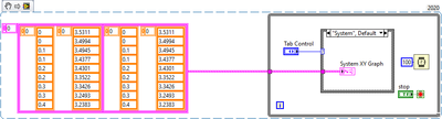

I have an application plotting a rather large data set in a system UI XY graph. When I update the graph the CPU rises to ~16% for the application. I replaced the system XY-graph with the classic XY-graph and the CPU stays below 4%. However when using the system XY graph, if i disable the first plot (Plot 0 Visible = False) the CPU decreases to the value of the classic XY graph.
I also made a small application just plotting the XY-data, and i see the same result. With system XY and plot 0 visible the CPU is ~2.5%, disabling Plot 0 the CPU goes to 0.5% which is the same as plotting all data in the classic XY.
Is this a bug in the systen XY indicator? Or is there something wrong with mine?

It's because the first plot in the System graph is anti-ailiased. The rest of the plots are not, and neither is the first plot in the Classic graph. Click the legend item for plot 0 and uncheck "Anti ailiased" and it'll drop your CPU usage, likewise, enable Antiailiasing on your Classic graph and it'll increase your CPU usage.
