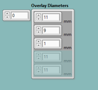

     I was recently training a new hire on a testbed I developed and it became clear that the nature of the individual controls isn't clear to everyone. For instance, the index display in the array below was meaningless to the uninitiated and it wasn't any more intuitive when I replaced it with a vertical scroll bar. My question is, does anyone no of a primer that is geared toward the end user to explain the visual language of the controls and indicators in LabVIEW? Thanks.

A finalized program should not even be identifiable as a LabVIEW program, so the right way is to make everything as self explanatory as possible. Yes, the "array index" control should typically be hidden. A scrollbar is more appropriate for arrays that can be of variable size. Do you really want the user to be able to change the array size by entering extra values at the end?  Don't forget the "tip strip" and "context help" to explain the function of controls, so fill in the related field in the "right-click...Description and tip".

I'm not familiar with what these controls are used for.  But if it is for setting an unknown number of values, then I'd suggest using a Single Column Listbox instead.  I've done this in the past with an Add and Remove button which prompts the user for the new value on add.  I've also added right click menus for Add Remove, Remove All, and allow for drag and drop to reorder if the order of the operations matters.
If I know the number of items isn't large I'll stick with the array, then I'll hide the index display, and I'll set the number of rows to the number of elements shown.  This way the user only sees the information they need which is the N number that have been added.  Only after there is more elements then rows will I add a scroll bar.  I have also in the past created a custom scroll bar that doesn't allow you to scroll past the number of elements that are there.

Thank you for your comments. I do want the user to be able to add and delete elements to the array. I typically avoid scrollbars because they can be hard to increment making it easy to miss elements. The suggestion of "a custom scroll bar that doesn't allow you to scroll past the number of elements " is aces for that and that is a wonderful solution to the example of the general problem.
My real concern is the general case of unfamiliarity with stock UI elements. To me, an index display just makes sense; to others it doesn't. I will continue to get better (hopefully) but will remain imperfect. I'm looking for any resource that can help bridge the gap between me and my operator. I know there are style guides for we the LabVIEW programmers, but is there anything targeted to the end user?
