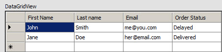

Has anyone succeessfully used .NET datagrid in LabVIEW UI.
.NET datagrid is basically a table data which can have both inputs (controls) and outputs(indicators).  The ability to have controls like buttons, checkboxes etc... inside the table is awesome feature of .NET datagrid.

Yes, we can do in that fashion of invisibling and visibling the cluster right on the row where user clicks.  But all such functionality is inbuilt in .NET datagrid.  I have attached couple of images from google search.https://i-msdn.sec.s-msft.com/dynimg/IC288774.png
http://beyondrelational.com/cfs-file.ashx/__key/CommunityServer.Blogs.Components.WeblogFiles/dinesh/DataGrid_5F00_thumb_5F00_652C4C2C.jpg

This looks like a project which would be of interest:
http://forums.ni.com/t5/LabVIEW/OpenSource-Project-for-a-NET-Datagrid-for-LabVIEW/m-p/3183494/highli...
https://github.com/unipsycho/LabVIEWdotNetDataGrid
Looks like they already have an example working:

Pete's pointed to a great open source project managing to use DataGrids in LabVIEW.
If you want to try this yourself, the following is an example that can get you started:

Those are good starting point to try. 🙂  I have tried it before starting this discussion.  I felt there is a lag in loading time when I use datagrid.  I can visually see that datacontainer is empty when I opened the executable and then it loads the data rows one by one.  Hence, I wanted to understand if anyone has successfully used datagrid in your application.  My application needs datagrid in many places (minimum 25 places as of now).  Will there be any other hiccups while use it in large scale?

I've seen the brief lag as well on initialization of datagrids, I've not tried anything to get around that yet but will certainly want to think about deferred FP updates, cached rows and constructors so that the building up of data for display is much faster.  I want to get the basics with events working first so at least it more usable in small scale before looking at large scale apps with so many instances. I'd like to actually build up a datasource for it eventually and then just connect the .net datasource and grids together, as I suspect that will be the fastest way to build up the rows, since that is the case in C# for them already.  Longer term though, thanks for the feedback, hope to hear more.
