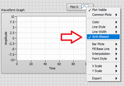

Is it just me or the waveform chart looks a loot better than the XY graph?
Is there a way to make XY graph that looks like waveform chart?
Or to be more precise, how to I get rid of those edges you see in the graph and make look smother like the chart?

Hi barukh,
enable aliasing in the plot properties…
(4,319 Views)
And be aware that redrawing will be significantly more expensive, so use it only for simple data with relatively few points. For each point, it needs to proportionally fill adjacent pixels with shades of the line color.
The pixelated lines are more of a problem on low resolution screens, but these are typical for less powerful computers/laptops which should not be overburdened by extra computations. Catch 22. 😉
(4,305 Views)
Thanks :).
That's what I like about Labview. Even after 10 years of programming with it there are still some hidden buttons I didn't knew about.
