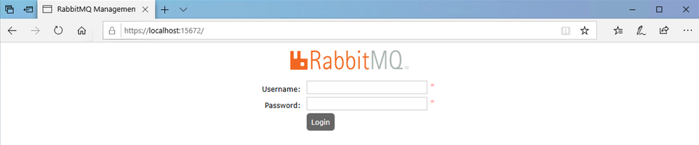

Open up a web browser locally on the server (Chrome or Edge) to https://localhost:15672/. It should look something like the following.
Then open C:\ProgramData\National Instruments\Skyline\SkylineConfigurations\skyline_localhost.json with a text editor and use the specified User and Password to see if you can log in.  It should look something like the following and will verify that the RabbitMQ web server is up and running.

I was able to verify it does connect, I was able to login using the password from the aforementioned .json file, but the approvals are still stuck. Is there a particular in which I should start/restart the services for this to work properly? Does the web server need to come up last? I would assume that this would be taken care of by specifying targets of each of the services.
