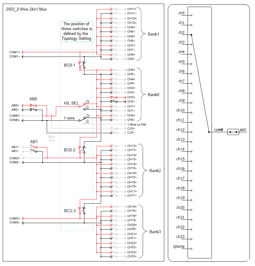

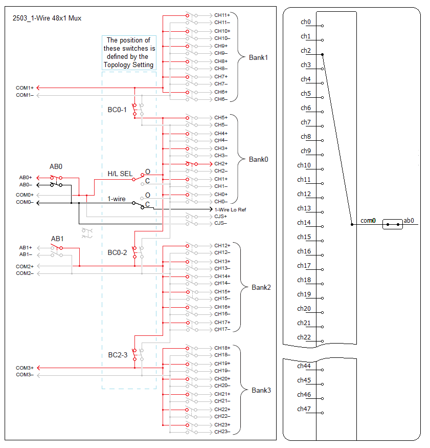

I made color drawings showing how a signal is passed from external connections to relays and back to external connections for most topologies.  The diagram on the left shows the path of the signal for one of multiple switch settings.  The particular switch setting shown is displayed to the right of the drawing the same way it is shown with the switch soft front panel display found in NI MAX.  Please contact me if you find any errors so I can make corrections.
This topology offers 48 connections to AB0+ but requires an external common connection if a second wire is needed.
2503_1-Wire 48x1 Mux2503_1-Wire 48x1 Mux
This topology offers 24 unique 2-wire connections to AB0
2503_2-Wire 24x1 Mux2503_2-Wire 24x1 Mux
