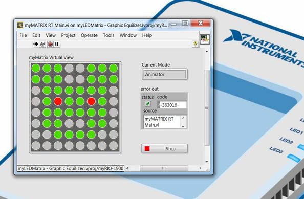

Also note that the front panel of the main myLightGrid vi includes 3 indicators, which display…
  • Virtual representation of the actual LED Matrix
  • Current Operating Mode
  • Errors and Warning
However, other than a stop button… there are no inputs/controls! This was a purposeful choice, as it allows myLightGrid to run heedlessly… completely disconnected from a PC.
