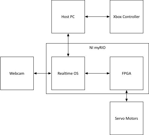

Systems Overview
There are three main systems within this project:
  1. Host PC – This will be a laptop used to interface with the Xbox controller and to monitor the status of the RT.
  2. Realtime OS – This is the Linux based operating system of the myRIO. This is where the majority of the processing for the PID control and machine vision will be done.
  3. FPGA – The low level code for controlling the servo motors will be ran here to maximise speed and determinism.
The high level overview of the system can be see below:

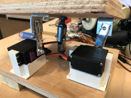

Building the plate system
A universal joint in the centre of the system allows for movement in the X and Y axis, whilst preventing any unwanted rotation.
Mounts were designed and fabricated for each of the servo motors using a 3D printer, this raised them from the base plate and allowed the full 180-degree rotation required to move the platform.

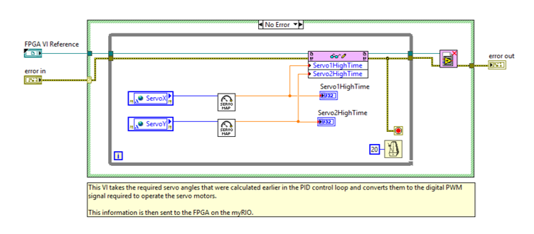

PID Control
Servo Driver

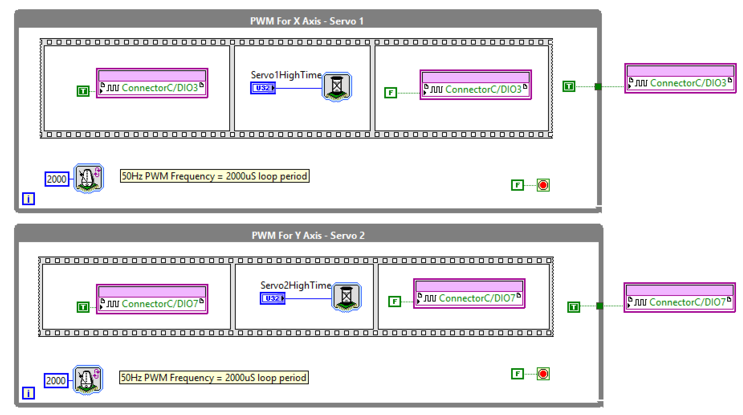

FPGA Code
The FPGA code is low level code that controls the state of the DIO pins on the myRIO. The values for ServoHighTime are sent to the FPGA via a DMA FIFO in the servo driver code on the RT. This is shown below:

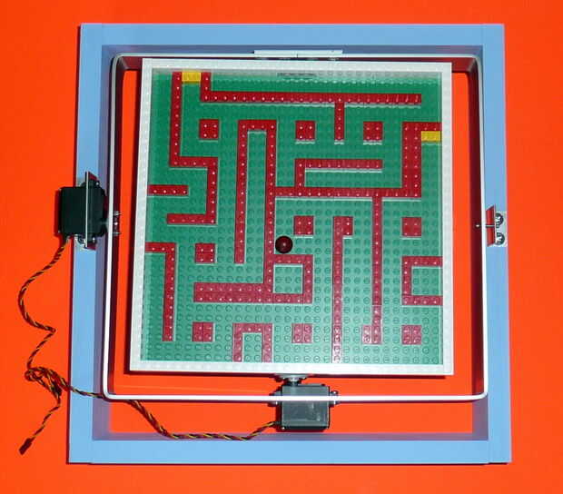

Great job. Could you please tell me what sort of polychromatic camera (wall detection, ball position) I should use for a LEGO maze?
link --> http://foto.askix.com/upload/8/7b/87ba0df9a831b4918f527f14abf3c6ae.jpg. Also, what camera specifications should I be looking at?
My project consist in solving a maze using image processing.
