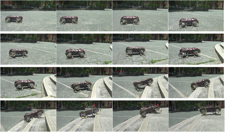

Aiming to develop the leg-wheel transformable robot with fast leg-wheel transformability for agile morphology adaptation to the largely existing hybrid environment, we reported on a new style of robot, TurboQuad, with different leg-transformation mechanisms and totally new bio-inspired behavioral exhibition and transition strategies, which overcame the limitations of the previous robot and achieved “hybrid” not only at the mechanism level but also at the behavioral level. Figure 1 shows the photos of the robot in wheeled mode and in legged mode, respectively. Figure 2 depicts the scenarios of the robot negotiating hybrid terrain: when the robot faces terrain change, it can rapidly change its behavior within one stride, similar to the gait change in animals.
Figure 1 Photos of the robot TurboQuad |
Figure 2 Illustrative scenarios where the robot adapts its morphology (i.e., wheeled or legged) to the terrain |

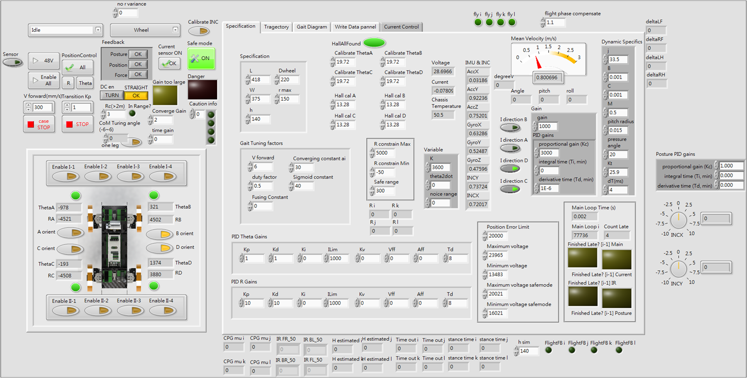

The LabVIEW program of the robot includes three portions: the main control program run in the microprocessor (RT), the interfacing program executed on the FPGA, and the GUI program installed on a laptop. The GUI mainly has four functions: sending high-level control commands to the robot, monitoring the robot’s health, adjusting control parameters, and data logging for further analysis.
In evaluating the performance of TurboQuad, the quantitative analysis is an important process. Owing to the changing computing resource demand in a complex real-time control system, some data points may be missed when using the traditional write to file function. In contrast, the FIFO function is a reliable way to record precise experiment data under heavy loading conditions.
Figure 6 shows the front panel and block diagram of the software.
(a) Block diagram of FPGA and RT |
(b) Front panel of RT |
Figure 6 LabVIEW Front panel and block diagram of the robot |

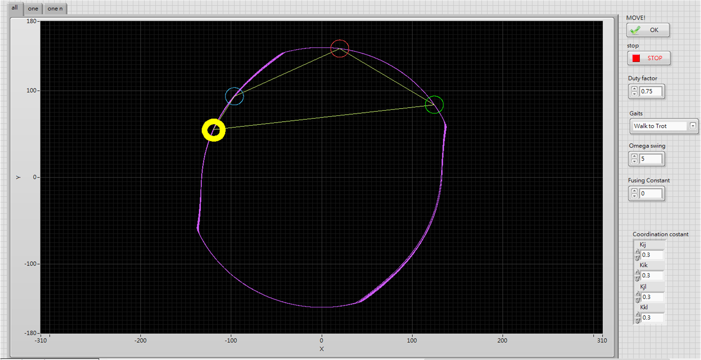

In addition, LabVIEW is also used to simulate the trajectory of the robot. For different gaits/modes of the robot, coordination of the leg-wheel should be maintained. During the development stage, the planned trajectory is first examined by the simulator before being sent directly to the robot. Figure 7 shows the trajectory simulator for the walking gait.
Figure 7 Trajectory simulator |

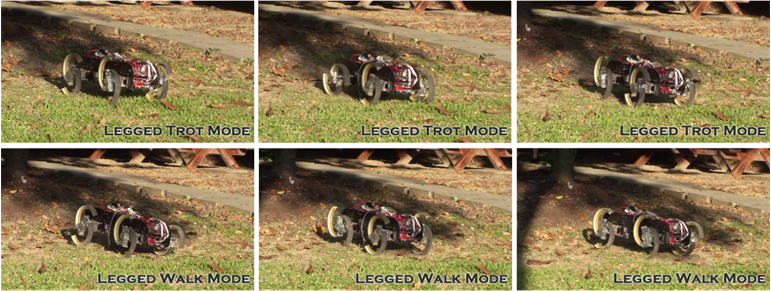

The CPG applied to TurboQuad consists of three layers: the command layer for high-level commands like speed and gait, the mode generating layer for trajectory generation and the motion layer for motor PD control. There are four dependent oscillators for each of the four legs. Each of the oscillators is linked to its adjacent ones, which makes coordinating the positions of all legs possible. Three modes/gaits and two model-based gaits are implemented, including a high-speed wheeled mode for use on flat terrain, a stable low-speed legged walking gait for use on rough terrain, a legged trotting gait for use on medium-rough terrain and two legged pronking gaits based on R-SLIP model and SLIP models. Based on the CPG strategy, the legs-wheels in all modes/gaits are coordinated in a rhythmic manner and the mode/gait can transit rapidly and smoothly. Figure 8 demonstrates the mode/gait transition for the three modes. Figure 9 shows a pronking gait based on the R-SLIP model with torsion spring leg-wheel and a pronking gait based on the SLIP model using force control with 2-DOF mechanisms.
(a) Wheeled mode to legged walk mode |
(b) Wheeled mode to legged trot mode |
(c) Legged trot mode to legged walk mode |
Figure 8 Transition between different modes |

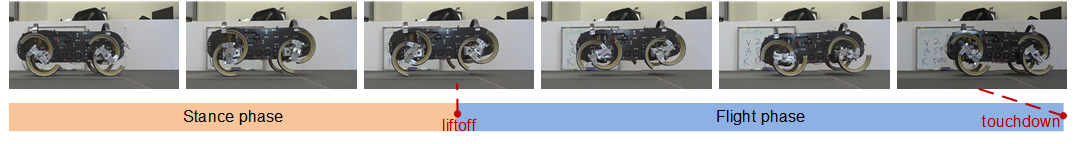

(a) Pronking gait based on R-SLIP model with torsion spring leg-wheel |
(b) Pronking gait based on SLIP model using force control with 2-DOF mechanism |
Figure 9 Model-based gait implementation |
