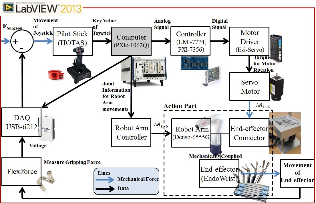

Control flow.jpgControl Flow of the Proposed System
For applying the HOTAS controller system to the existing laparoscopic surgical robot system, the NI Motion controller was used with NI PXIe platform.
Furthermore, the algorithm for control system was developed with LabVIEW 2013 and Imaging Lab Robotics Library for DENSO, since the end-effector is mounted on the DENSO robot arm in our system.
Therefore, the integrated system of HOTAS system, NI Motion controller, servo motor and end-effector was successfully developed for the development of the next generation laparoscopic surgical robot system, as described in control flow diagram.
In addition, a flexiforce sensor and a 6-axis force/torque sensor were used in this system for the evaluation of robot system’s performance, and they were integrated with LabVIEW 2013 using the DAQ and serial communication system relatively.

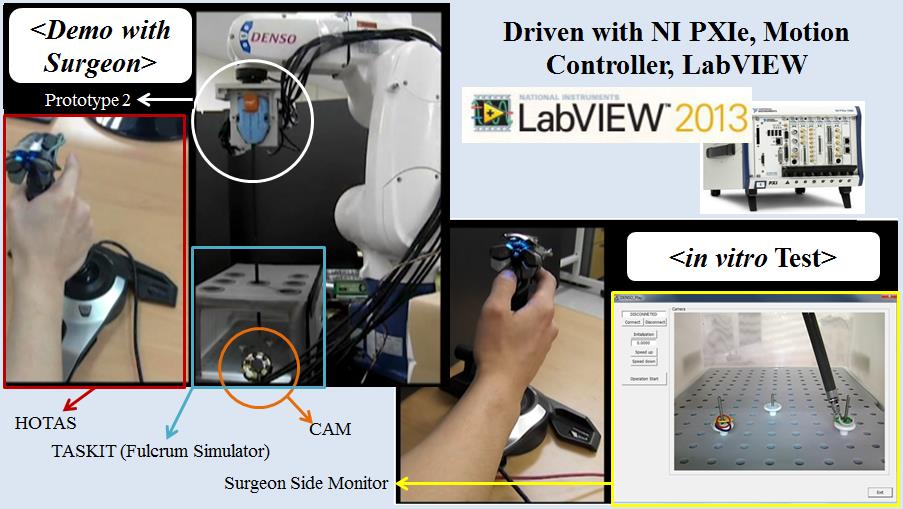

As a result, it was confirmed that the proposed robot system was able to generate a bigger force than that of the da Vinci robot system, and the size of the whole system was also reduced.

Demo.jpgDemo with Surgeon and in vitro Test using NI Hardware and LabVIEW
