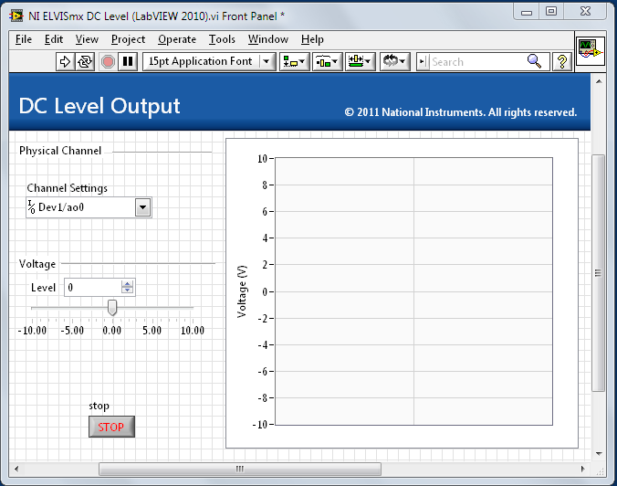

The NI ELVISmx DC Level is an instrument that generates a DC voltage from the analog output channel. You can set the voltage control to vary the voltage from +10 volts between -10 volts.

Complete the following steps to output a voltage with the NI ELVISmx DC Level instrument:
  1. Select the Channel Settings to correspond to where your signal is output on the channel of your hardware device.
  2. Enter the desired voltage for each supply in the Voltage level control, and the output updates between +10 and -10 volts.
  3. Click the Run Button.  You should see the desired voltage in the display window.
