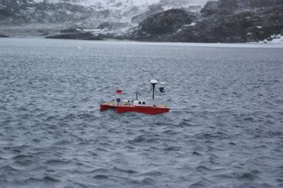

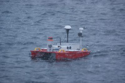

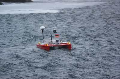

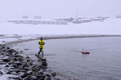

ARCAB featured in an expedition to Greenland in January 2019 where scientist Dan Carlson from Aarhus University, Arctic Research Centre, used ARCABs capabilities to map several fjords and bays around Nuuk, Greenland. During this expedition, ARCAB was deployed from both vessel and shore. It was used in both RC and autonomous mode. During the expedition, only minor adjustments was conducted on ARCAB, relating to direction calculations from GPS signals, even though the environment in which it was deployed was both colder and windier than described in specification of requirements.
ARCAB was deployed near Nuuk, Greenland's capital, in early January 2019. The 1st deployment took place 7 January 2019 in Kobbefjord in a shallow (2-7 m) embayment. ARCAB carried out two autonomous missions, mapping bathymetry within meters of the shoreline in depths < 2 m. The second deployment took place 8 January 2019 in a small bay in southern Nuuk. ARCAB operated autonomously and under remote control in air temperatures of - 15°C to -10°C and with steep, choppy waves. ARCAB was deployed from a small boat and from shore and acquired bathymetry data close to navigational hazards that would make the operation of manned vessels too risky. During autonomous navigation ARCAB maintained a nearly constant speed of 1 m/s along survey lines, slowed during turns, and stopped at the end of its mission.
ARCAB in Greenland waters.ARCAB in Greenland waters.   ARCAB in Greenland waters.ARCAB in Greenland waters.   ARCAB in Greenland waters.ARCAB in Greenland waters.
ARCAB functioned under colder weather than specified, even in snowy conditions.ARCAB functioned under colder weather than specified, even in snowy conditions.  ARCAB in Greenland waters close to ice.ARCAB in Greenland waters close to ice.
ARCAB deployed from shore.ARCAB deployed from shore.  ARCAB being deployed from a quay.ARCAB being deployed from a quay.

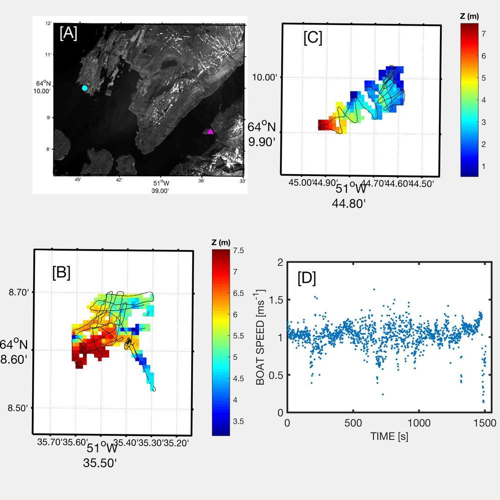

Data acquired by equipment on ARCAB during mission in GreenlandData acquired by equipment on ARCAB during mission in Greenland
[A] 15 m resolution panchromatic Landsat-8 image (https://earthexplorer.usgs.gov/) that shows the Nuuk area. The test loca- tions in Kobbefjord and Nuuk are indicated by the magenta triangle and the cyan circle, respectively. [B] Gridded depth data recorded by ARCAB in Kobbefjord on 7 January 2019 with the vessel track overlaid in black. [C] Gridded depth data recorded by ARCAB in Nuuk on 8 January 2019 with the vessel track overlaid in black. [D] During autonomous sailing ARCAB maintained a nearly constant speed of 1 m/s, slowed during turns, and stopped at the end of the survey.[A] 15 m resolution panchromatic Landsat-8 image (https://earthexplorer.usgs.gov/) that shows the Nuuk area. The test loca- tions in Kobbefjord and Nuuk are indicated by the magenta triangle and the cyan circle, respectively. [B] Gridded depth data recorded by ARCAB in Kobbefjord on 7 January 2019 with the vessel track overlaid in black. [C] Gridded depth data recorded by ARCAB in Nuuk on 8 January 2019 with the vessel track overlaid in black. [D] During autonomous sailing ARCAB maintained a nearly constant speed of 1 m/s, slowed during turns, and stopped at the end of the survey.
ARCAB performed well in both test deployments in Aarhus, Denmark in May 2018 and in southwest Greenland in January 2019. ARCAB demonstrated its stability and wave-piercing capabilities during the January 2019 deployment in Greenland. ARCAB navigated multiple autonomous routes within the speci ed boat speed and waypoint radius parameters. Overall, ARCAB satis ed all the design requirements.
