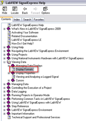

You will need to use a waveform chart which is only available with scalar data.  Depending on your system, you can try using one sample on demand to obtain the scalar value.  You can also try to implement processing like the Amplitude and Level step which will produce DC and RMS scalar values.  See the Display Formats section of the Signal Express Help for more information.  Hopefully this helps!
