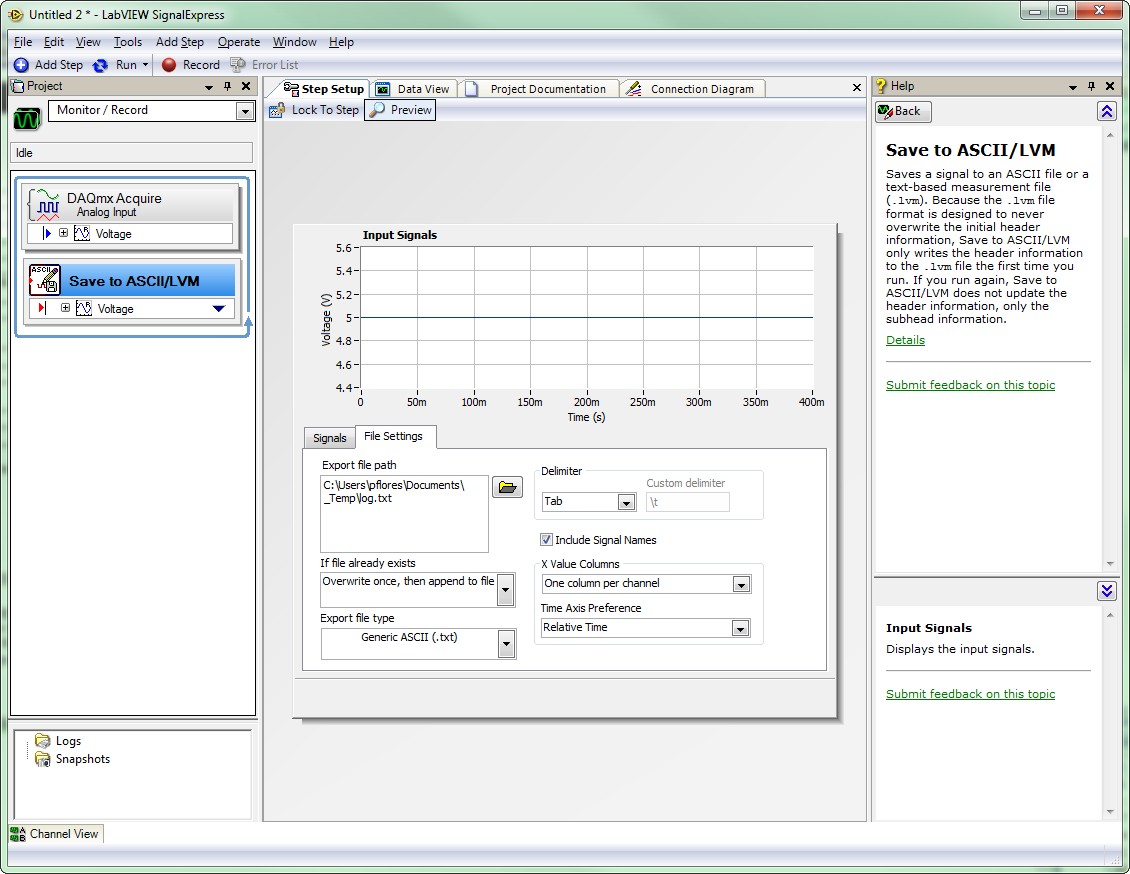

Hello Peter,
I'm using version 3.0.0 of SignalExpress. I've imcluded a screen shot. To acquire data I'm using the step Acquire Signals>>DAQmx Acquire>>Analog Input. While for Saving data I'm using the step Load/Save Signals>>Analog Signals>>Save to ASCII/LVM.

Ronak,
If you use the Absolute Time option, you will get a log similar to log.txt attached. The time column actually represents the unmber of milliseconds since midnight Jan 1, 1904.
To stay with relative timestamps, I created a dummy signal to act as the time column. See the attached screenshot and log.
