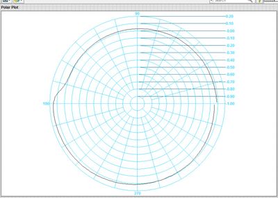

I am working on a project to read a variable input eddy current sensor and see it as a waveform. The profile of the rotating object that we are detecting is such that it creates a saw tooth pattern. What I am trying to accomplish with this is to create a specific drop off point with a constant value that can be seen on the waveform. I need to be able to have this value stay the same at any rpm up to 60rpm.
I can generate the front slope to a specific known window - but I cannot figure out how to insert a constant value into the waveform in place of the drop.

I think I was not clear before, as the vertical line is ok to transition over time but it just needs to be as vertial as possible. I am trying to measure distance from the end of the eddy current sensor on a single helical coil that intersects itself. (basically draw a circle with a decreasing radius, where the circumfrence does not meet at the same start/stop point ant draw a vertical line to connect the two open ends together). I am trying to use the upset to measure rpm, which it does. The problem comes in when the eddy sensor lands on that upset at stop and I get hundreds of varying readings (all within the range of the hieght of the profile) so LabVIEW cannot determine if I am stopped or going really fast.
So I would like to insert a constant into the wave profile there and ignore the sensor until I start rotating again. Or figure out a way to generate a duplicate waveform and set it as an out of phase comparison for a reference without having to use two sensors.

So the issue I am trying to correct is for the size of the sensor head on the eddy current sensor. As the edge profile passes in front of the sensor there is a point on the sensor head where it reads an inconsistent distance. this distance is interpreted as shown on the graph when you zoom in on a falling (or rising in reverse) edge. At slower revolution this falling edge grows over time to the point that the falling edge can look more like a sine wave than a sawtooth wave. This inconsistency is not good when in actuality it covers the same edge of the profile. Look at these two polar plots of the sawtooth to get an idea of what i am trying to correct via programming.
I am trying to program a consistent edge profile like the one on the right (high rpm) to insert into the profile on the left at slow rpm. Considering that the waveform generated comes from a constant 1-d array of numbers that are the measurement of the same profile over and over I was thinking about setting up an insert into array function that replaces that falling edge set of points two a constant two or three numbers... Anyway still playing with the numbers and the program.

It sounds like this behavior is based on some limitation of the eddy current sensor being used.  Is the sensor sampling too quickly to make sense of the vertical face of the object being scanned while the object rotates at low rpm?
So the behavior is acceptible at high RPM because the eddy current sensor can only take one or two readings of the quickly-changing vertical face?

So I have been testing some different profiles on the test piece and selieve that the issue is a timing limitation within the cRIO card itself. The eddy sensor transmits data at 20,000 times a second (20khz) while the NI 9207 has a resolution in high speed mode of 2ms per channel and has to scan 16 channels before returning to the data from the sensor. So that roughly translates to a frequency of about 30 Hz from the card to the FPGA.
All that really means to me is that i should have a resolution of about 34 deg at 180 rpm and about 2 deg resolution at 10 rpm. However, I am only getting a best resolution of 16 deg at any rotational speed. So I am loosing data somewhere int the transition.
So thanks for the input. I am agreeing with yo that it a timing issue that needs to be resolved not a waveform correction.
