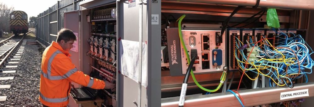

The input/output modules (listed in Table 1) were selected based on the project requirements and their compatibility with the selected controller. The CompactRIO along with the motor controllers and other electronic equipment is installed within the lineside location case (Figure 4).
Figure 4: Location case with the CompactRIO
