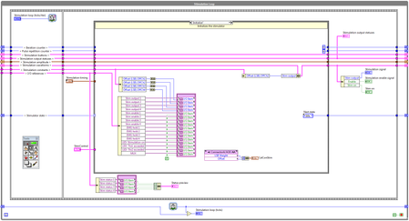

We chose the NI myRIO device as the embedded controller. We used it to measure the signals from the EMG amplifiers, carry out real-time processing on the data streams, and generate the signals for the stimulation amplifiers. A custom LabVIEW application, running on a standard laptop, wirelessly connects to the myRIO to provide a graphical user interface (GUI) and data logging. The GUI is required for configuring the processing and stimulation parameters, providing real-time visualisation of the signals, and setting-up the data logging. However, we use the myRIO integrated FPGA for time-critical tasks. Generation of accurate square wave stimulation pulses with pulse widths less than a millisecond wouldn’t be possible without an FPGA program running at tens of kilohertz. We also currently sample and process the EMG signals in the FPGA because a high sampling frequency allows fast detection of the onset of muscle activity from the background noise.
Figure 4. Example Section of the LabVIEW FPGA Program: Initialisation of myRIO I/OFigure 4. Example Section of the LabVIEW FPGA Program: Initialisation of myRIO I/O
The myRIO greatly simplified the design of our prototype system, allowing us to implement a vast amount of functionality on a single device—from analog and digital I/O, to customized signal processing, to wireless connectivity. We use analog I/O to measure and generate signals. We need digital I/O to toggle our amplifiers and physical indicator LEDs and to read UI buttons and the status indicators of our stimulation amplifiers. The built-in wireless connectivity of the myRIO was important because we designed the prototype system to be a medical-grade device. Physically connecting it to a computer would have caused safety concerns. Choosing myRIO as the system controller was also a future-proof design choice. NI RIO architecture helps us easily reuse all of our current software IP, whilst upgrading from myRIO to a higher-end processing target (such as Single-Board RIO) with larger FPGA capacity, if required in the future.
