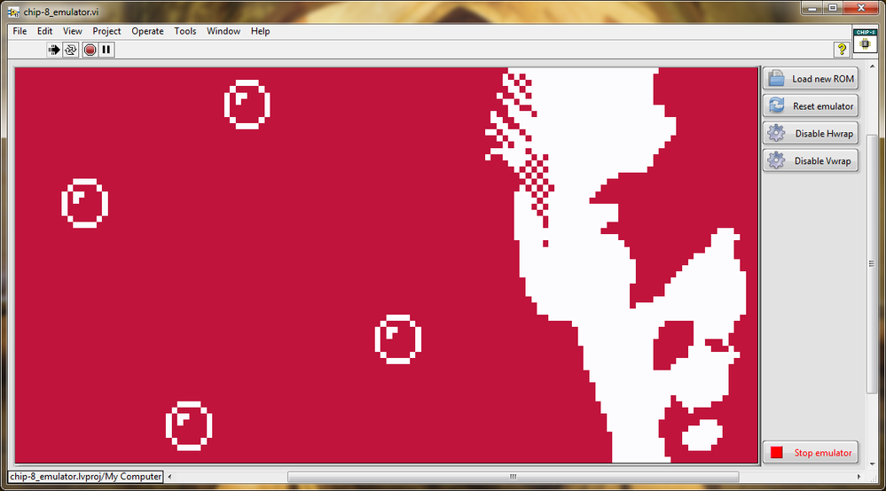

The following screenshots show the LabVIEW CHIP-8 emulator in action:
Tetris by Fran Dachille (CHIP-8): a surprisingly complete game of Tetris that plays very well.  Due to the primitive sprite handling and XOR-based collision detection, you can see a single pixel being scanned across the blocks whenever a tetronimo is placed.Tetris by Fran Dachille (CHIP-8): a surprisingly complete game of Tetris that plays very well. Due to the primitive sprite handling and XOR-based collision detection, you can see a single pixel being scanned across the blocks whenever a tetronimo is placed.
Blinky by Hans Christien Egeberg (CHIP-8): an homage to the classic Pac-Man in 64x32.  The power pills are missing and there are only two ghosts, but the game is quite playable.Blinky by Hans Christien Egeberg (CHIP-8): an homage to the classic Pac-Man in 64x32. The power pills are missing and there are only two ghosts, but the game is quite playable.Joust by Erin Catto (S-CHIP8): a faithful clone of Joust with two AI opponents, multiple levels, a lives counter and collision physics.  Defeated enemies turn into eggs that must be collected quickly otherwise they return to battle atop their faithful ostrich, lance in hand!  Joust is weird…Joust by Erin Catto (S-CHIP8): a faithful clone of Joust with two AI opponents, multiple levels, a lives counter and collision physics. Defeated enemies turn into eggs that must be collected quickly otherwise they return to battle atop their faithful ostrich, lance in hand! Joust is weird…SuperTrip8 by Revival Studios (S-CHIP8): an impressive demo for the S-CHIP8 with fancy screen transitions, pseudo-3D effects and sprite trail animations.SuperTrip8 by Revival Studios (S-CHIP8): an impressive demo for the S-CHIP8 with fancy screen transitions, pseudo-3D effects and sprite trail animations.

The CHIP-8 emulator project is included in all LabVIEW classes that I teach as an optional, student-lead exercise that allows students to practice modifying existing code either alone or in a development team and critiquing coding style against a specification.
How do I get started?
Load the project “chip-8_emulator.lvproj”.  Under the virtual folder “main”, open “chip-8_emulator.vi” and run it.  The splash screen ROM will load and run.  You should see the following:
LabVIEW CHIP-8 emulator splash screen.  The splash screen is presented in S-CHIP8 mode (128x64).LabVIEW CHIP-8 emulator splash screen. The splash screen is presented in S-CHIP8 mode (128x64).
There are five buttons on the front panel:
