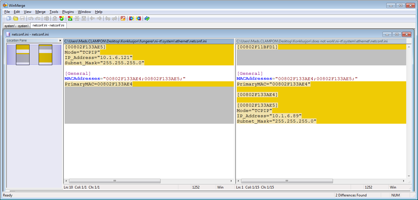

I just spent 1,5 weeks of bug hunting trying to figure out why one of two CFP-2220s refused to respond if it happened to have both Ethernet ports connected (it would boot properly if either only port 1 was connected at startup, or if one of the ports were connected to a network with a DHCP server, OR one single reboot if I removed the TCP_Stack section in the ni-rt.ini file...). The application ofn the controllers does some IP switching using the System Configuration API so I spent a lot of time thinking that had something to do with it, but could finally isolate it to the ni-rt\system folder..and when I did a file diff on all the files between a working system and a non-working one the netconf.ini file put me on the right track:
Here's a copy of the netconf.ini comparison, with the working one on the left and the non-working one on the right. I'v been using the RTAD utility from NI to apply the same image to 8 controllers - so I had one controller that worked fine, probably because that is the one that the image was based on...

Hi Mads,
The CAR ID number is actually 190786.  This CAR has not been published online, we typically only mention fixed CARs in the readme files for our software installations.
This car has been closed out because we are planning to deprecate the RT system replication VIs and move to the System Configuration system replication VIs owned by MAX.  This CAR has already been handled in Measurement & Automation Explorer version 4.8.
The Measurement & Automation Explorer VIs are located the Functions Pallet under Measurement I/O»System Configuration»RT Software.  These VIs should be able to perform for functions you are looking for.
