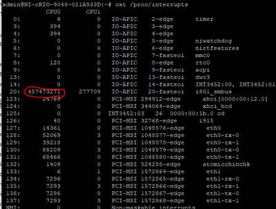

  I have been running into high CPU usage on a cRIO-9048. Even with no RT VI's running, I am often in the 30's of percents. I have done a little digging, it seems that the i801 SMBus is firing lots of interrupts. This interrupt is consistently consuming 20-25%, sometimes even more.
Does anyone know what this is for? I am considering disabling interrupts for this. However, I would really love to know what it's doing before I go and disable interrupts.

Still digging into this. It seems that it is a bug specific to the Atom processor in the cRIO-9048.
This issue has been resolved as of Linux kernel 5.12. Unfortunately I am on 5.10 that comes with firmware version "8.8.0f0". Does anyone know if there are updated versions of the "NI Linux Real-Time x64" OS that I can download from somewhere? I tried downloading the latest version of "NI Linux RT System Image", but I do not see a newer firmware included with that that I can install using NI-MAX.
Any help would be greatly appreciated.
If anyone is interested in learning more about this bug read the following : https://bugs.launchpad.net/ubuntu/+source/linux-hwe-5.11/+bug/1931001

Feels weird to mark my own post as a solution, but I did find solution if anyone ever has same issue.
I tried downloading and installing 2023Q4 cRIO drivers .... same 5.10 kernel.
Opened NI support ticket and they responded with two possible fixes.
1. Update BIOS on cRIO. This is not easy to do as the USB ports on PC's in my enterprise are quite restrictive, so I can't make a bootable drive.
2. Instruct modprobe to ignore i801_smbus interrupt. This worked.
Run the following line over SSH:
echo "options i2c-i801 disable_features=0x10" >> /etc/modprobe.d/i2c-i801.conf && reboot.
