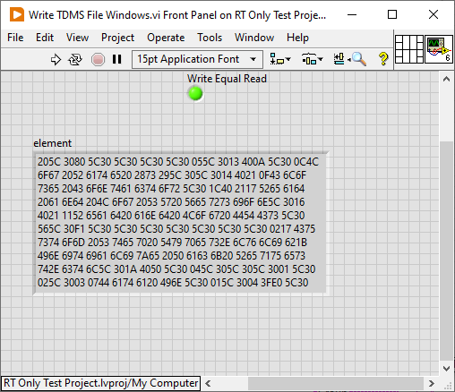

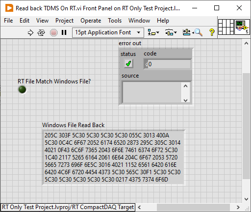

I have a Windows machine that makes a TDMS file, then it FTPs it over to the RT system, where it is then read.  I'm seeing data now that when read back on the RT, doesn't match the data that was written on Windows.  Attached is two VIs, one for making the Windows TDMS file, then you need to copy it over to the RT system, and run the second VI which will read the file, and tell you if the data matches (there is a string constant of the expected result).
What am I doing wrong here?  Is there some weird Linux thing in regards to reading certain strings?
You can see the 4th byte doesn't match.
LabVIEW 2020 SP1, RT Linux on cDAQ 9136
EDIT: Okay so this is an extended ascii isn't it?  On Windows I write 0x80, and on Linux it reads it as "?". Do I just need to only use the first 7 bits and have a padding routine to only use those?  Isn't this still a bug?  I mean the TDMS read is supposed to just return the bytes but LabVIEW is changing them.

I think it has to be a bug, at least what I'm seeing on the 9627. Either RT is mistaken and the file is correct and we shouldn't get an error 6 when we read it or Windows is generating a corrupt TDMS.
Interestingly, if I create the file on the RT target and read it back on the Windows side, I reproduce the behavior you saw on the RT side. Windows gives up trying to interpret the euro symbol (I can see it in the hex of the TDMS) and just outputs a question mark (ASCII 63). So, there's an issue in that direction too. Either RT is goofing the representation of the euro symbol or windows is goofing the interpretation of 0x80

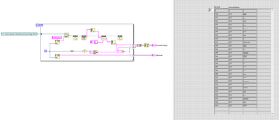

Sooooo, this suddenly became a problem for me.  So, I poked into it a bit.
I wrote a script to write 256 tdms files on a LV-RT target.
Each tdms file writes 1 character type.
I then FTPd these back to Windows and inspected.
I found that the following characters appear to be the troublesome characters:
More specifically, when these characters are written to a TDMS file in RT, and then read back in Windows, Windows returns the character as "?"
It's super weird to me that the troublesome characters don't appear to be the entire extended ascii character set.  Just a portion of it.
For maximum optimization purposes, I'm going to try to implement a padding strategy that only pads these characters instead of the full extended ascii set.
All of this work assumes that the issue here is strictly limited to singular "do not use" characters.  i.e. I didn't test and patterns of characters.
I suspect that this is a safe assumption.
Lastly, I confirmed that these files all read-back in RT without issue.
So, this just confirms our observation that the issue happens going from Windows to RT, or from RT back to Windows.

I've attached my padding escape strategy for anyone who finds it useful.
I've verified that this appears to work for TDMS files written in RT, FTPd to Windows, and read in Windows.
Again, I haven't tested going from Windows to RT
Message 9 of 15
(3,709 Views)
