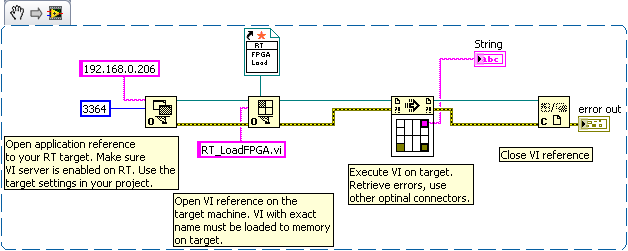

I am trying to run a single VI (either on the compactRIO RT or on the connected host PC) and have it run code on the host PC, the RT target, and the FPGA code. I currently have code running on the host PC that opens the FPGA reference and runs the FPGA code, but I am not sure how to do this with a VI on the RT target. Any advice/help would be great. Thank you!

This is close. I want the VI running on the host PC to run a VI from the RT on the RT. Your links are helpful but I have no idea how to use the VI server to accomplish this. Perhaps I am missing something. Any additional advice? Thank you!

Hi Brandon,
try this:
On the host side:Host_Main..png
Make sure IP address and port of VI server matches target settings.
On the RT target:RT_Main.png
Inside RT_LoadFPGA.vi: RT_LoadFPGA.png
1st start the VI on RT target
2nd run the VI on your host
Swen

I still don't think this is quite what I am looking for. I want to build this to an executable that I run on my host PC. When I run it, I want it to automatically run code on both the RT and the FPGA. I am going for the simplest possible solutions as my users will likely only know to double click an icon. I'm sorry if I'm not getting it, but I have never used the VI server before.

You're not far away from reaching your goal. But you need at least
  1. Compiled FPGA code (Bitfile) containig your code to run on the FPGA.
  2. A compiled executable for your RT target, set to autostart.
    You could use the code from my first post as a starting point. Compile, deploy and set it to autostart on your RT target.
  3. A compiled executable for your Host machine; the one your user will start.
    You could use the code from my first post, maybe load settings IP Address, Port etc. from Ini-File.
If you double click the exe on your host computer it will open an application reference to your RT target machine and call the VI on that target machine. Thats how you can run code on your RT. From this RT code you can download and run the FPGA code (bitfile) to your FPGA, or control the already running FPGA code by controlling a state-machine. Load more VIs to your RT targets memory and call them from your host to add more funtionality if you need to.

Ditto! You could even go as simple as have your PC code have a shared variable "start" that when ran sends a boolean true value to your RT code that is a startup executable waiting for a "start" (boolean true) signal.
