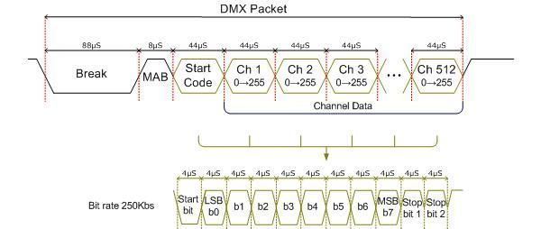

DMX512 protocol:
https://en.wikipedia.org/wiki/DMX512
Baudrate = 250kbaud
The content of a frame comprises a set of serial bytes (slots) sent with eight bits of data, one start bit, two stop bits. The frame starts with slot 0 and ending with the last implemented slot, with a maximum total of 512 slots.
The frame composition of a n-byte DMX Frame may be summarised as:
  1. Break
  2. Mark After Break (MAB)
  3. Start Code
    1. Start bit
    2. Start Code (8-bit Value)
    3. Stop Bit
    4. Stop bit
  4. Mark time before 1st data slot
  5. For count := 1 to n ( Max. n of 512)
    1. Start bit
    2. 8-bit Slot Value
    3. Stop Bit
    4. Stop bit
    5. Mark time between slots

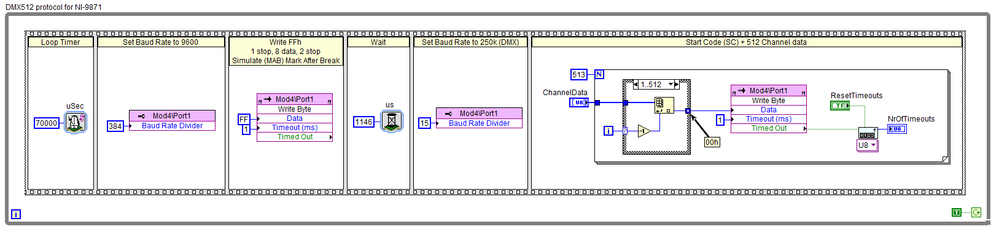

FPGA Implementation:

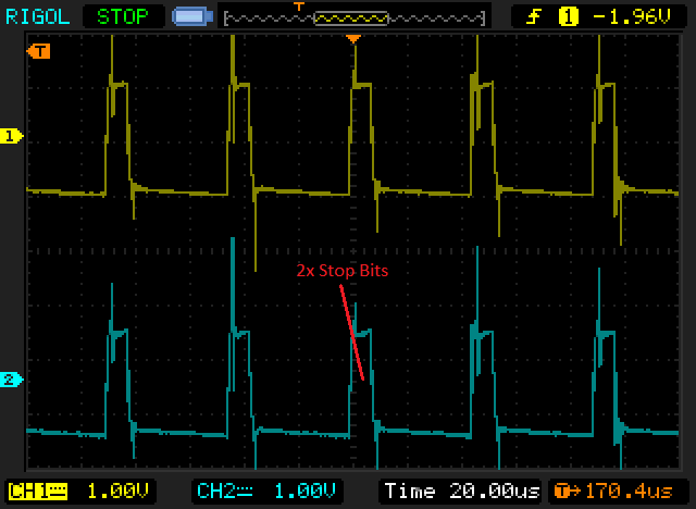

Measurement:
I'm measuring pin 8 and pin 9 each with a probe, on the DB9 connector. I'm fairly confident that I have the shape of the DMX protocol correct from previous testing. What you are seeing here are the 2 stop bits of each frame with 00h as data. From my understanding of RS485, one of the signals on the scope should be inverted. I think this is the reason that my RGB light does not react on the signal that I'm sending to it.
Am I'm doing anything wrong here? Smiley Sad Please help. Kudos will be given. Thank you.

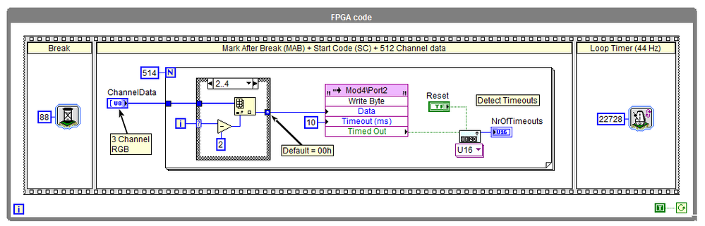

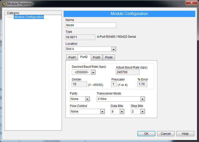

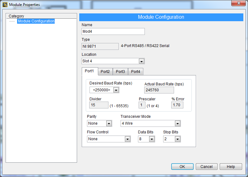

I solved the problem. It is important to note that the RJ50 to DB9 converter from NI is used in combination with TEDS and is NOT a one to one convertor. This was the reason that my signals on my scope were not what I expected.
To create the DMX protocol on an FPGA using the NI-9871 module, you can use this code:DMX.png
