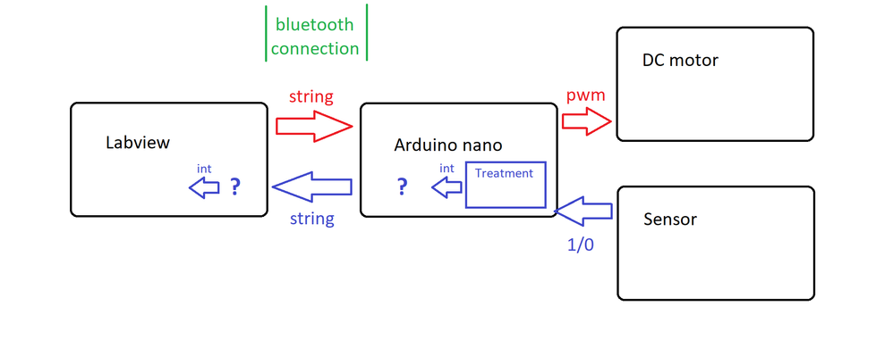

I work on a project where I have to control  DC motor using LabView, an Arduino nano, both connected by bluetooth.
For now, I can control the speed of the motor.
I can get values from an light blocking sensor to calculate the speed of rotation of the system with an encoder.
I can't send the right value to LabView but it's another problem and another topic ( https://forums.ni.com/t5/LabVIEW/LV-Arduino-bluetooth-communication-String-integer-convertion/m-p/38...: )
Here is a little diagram to explain my project. Don't pay attention to the string to int convertionBlocs2.png
But I have an issue with the PWM. When an interruption starts, the PWM changes until the end of the interruption:

Hello nitneuk,
After looking at your code in LabVIEW I don't see any problem with it. I think your problem is more an Arduino-sensor one. The most appropriate action may be to ask this question in an Arduino-focused forum? (https://forum.arduino.cc/ for example)
If someone in this forum is competent in this subject (Arduino), feel free to reply!
