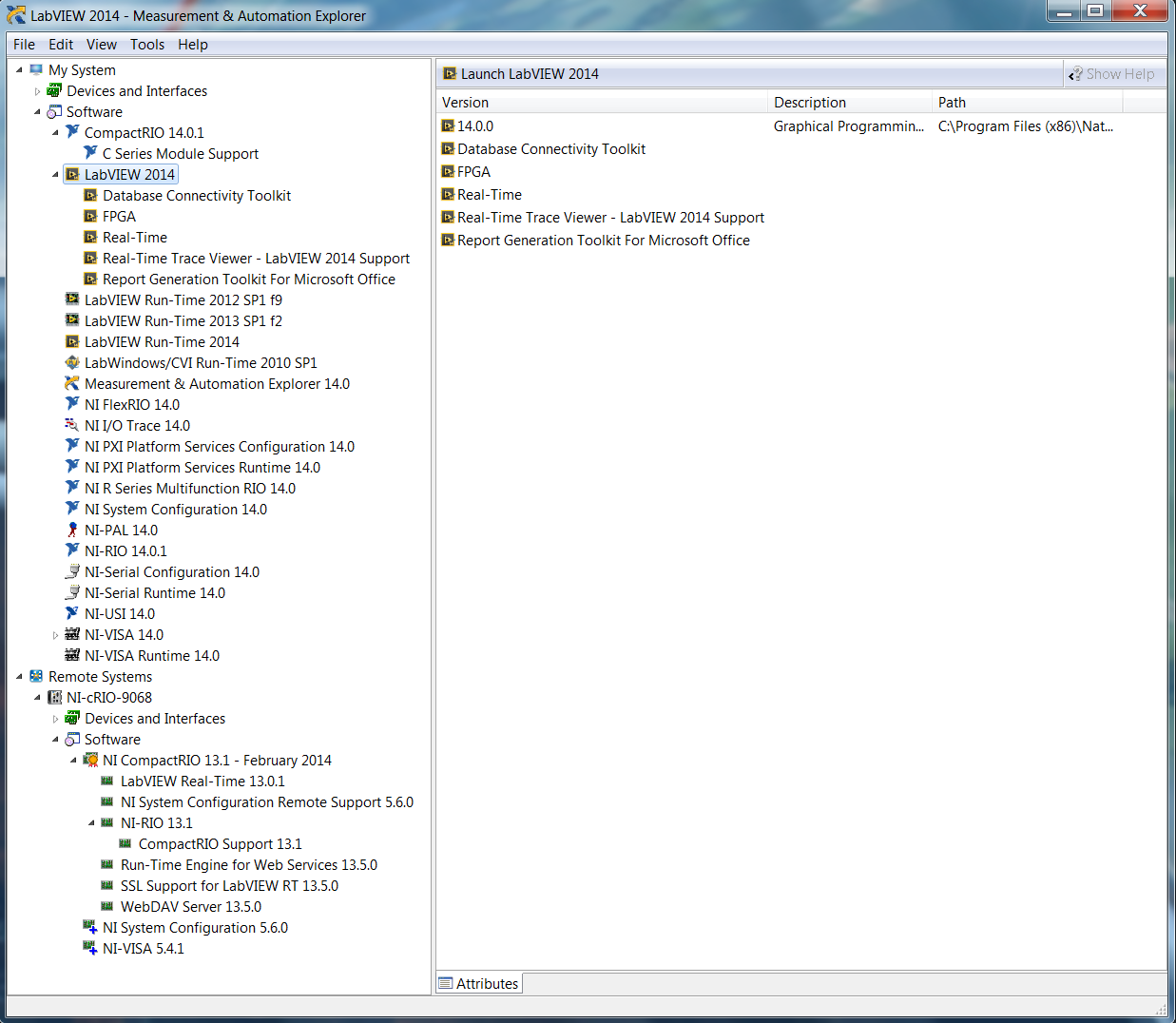

I have connected a Compact Rio 9068 directly to my computer (HP EliteBook 840 G1, Windows 7), and the system appears in the tree under Remote systems in MAX. However, the problem is that I can only see information under the System Settings tab, while the Network Settings tab is entirely empty (blank white page). I have tried to refresh and re-boot, log in as admin, but it doesn't help. I assume that I have to change some network settings on my computer but I do not know which and still think it is strange that nothing at all appears under this tab.The windows firewall is set to accept NI MAX for both office/home and open networks. Can anybody help? Below you see how it looks in MAX for the two tabs.

The latest Labview version and Real-time module is installed from NI download webpages, Real time module is also shown when looking in the software tree in MAX (see figure below).

Looking from the images in earlier posts you have different version of LabVIEW on the cRIO and on your computer. Reinstall the software on the cRIO so both have LabVIEW 2014 and corresponding software components.
Right click on software under your cRIO and choose Add/remove software. Follow the wizard to reinstall.

A matching software stack is not required to set settings in MAX for a target. To program the target you must have matching versions of software.

thank you. This did still not help. I'm now trying to reinstall all NI products on my PC. I saw that the driver has a newer version 14.0.1 and the other software 14.0.0, do not know how this happened and if it matters, downloaded all files on one date from NI webpage.  Noticed this when I tried to install the same version 2014 software on the CRio using the wizard as you suggested, and then the driver did not show correctly (! warning icon in front of the driver) in the tree under Labview Real Time 14.0.0 (step 3 of the install wizard).
