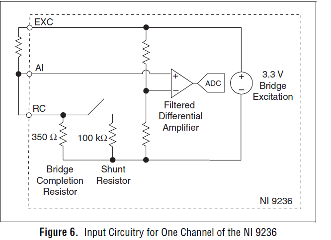

On page 12 I have this diagram. Please explain how I could connect my load cell is full bridge 4 wires. thanks for the information

Good morning,
Sorry, this module is only 1 / 4 bridge, the bridge is not complete.

In conclusion, Not is posible conect 1/4 bridge module.. full bridge load cell. Is it Correct????
Message 5 of 11
(5,789 Views)
Accepted by topic author ANDRES_VANEGAS
Yes.
