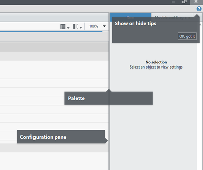

  • The tips function isn't very useful (pretty sure there's no palette in the Table view too)
  • The Zoom function does nothing in the table view (fair enough, but then why show it?)
