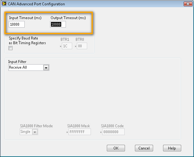

Hi Mehd,
I think I found your problem:
The default  input and output timeout for the CAN module is 10000 ms hence 10 seconds. This means your CAN read operation takes up to 10 s if there is no frame received on the CAN bus.
 So you either change the timeout for your modules in advanced module settings in project explorer (check the error cluster, no error only if a real CAN frame was received, in timeout case: error) or you decouple CAN an SIT loop (see attached VI)
Hope this solves your problem!

Hello Andreas,
thanks a lot for your reply !!!
The problem was exactly what you explained ! I wonder why the default value of the timeout is so big !?!
Fortunately I found the solution before one week and since the application works all right !
