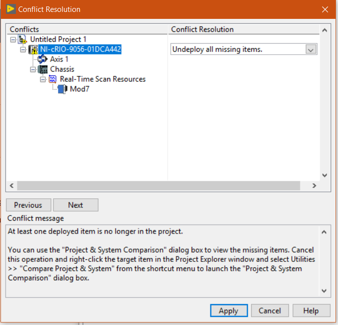

Hi everyone,
I'm learning recently how to bring a servo motor into working but got stuck at the very beginning. I followed the tutorial https://www.ni.com/docs/en-US/bundle/375516e/resource/375516e.pdf and when I clicked deploy all (in page 19) this message appears "NI SoftMotion: The specified device was not detected" and the deployment completed with errors. And as a result I can't find any device in the motor control software(not very sure if there is any relationship). What can be the problem and how should I fix this? Any reply is appreciatedSmiley Wink!

Thank you for your reply! I'm not using any FPGA for now, so there is nothing in the project now. I guess I'm doing initializing steps before everything can work and such error appears. And the module is added to the project. Not sure if I correctly get your point. Oh another thing is that after the first failed deployment today I tried again and a conflict message appears "At least one deployed item is no longer in the project". I can choose to unploy all missing items or not but both options lead to the same error I metioned above.  So I'm getting even more confused.

Hi ZeSuli,
I also tried to run this NI 9514 with cRIO and I received the Axis Error. I think the problem is related to the software itself. Every single piece of software should have exactly the same no, I mean: NI RIO, NI Industrial comms for EtherCAT, NI RT, NI FPGA, LabVIEW == 18 In the manual you've sent there is also a note that you need to install the NI Scan Engine support while installing NI Soft Motion Module.
Check the compatibilities, and try to run the simplest project possible: only crio and 9514, single axis and check the status LED on the module.
I will also try to do this but downgrading the software may take some time.
Edit:
In a meanwhile, I've found this document: https://www.ni.com/en/support/documentation/compatibility/17/softmotion-compatibility-with-labview-r... your cRIO is not listed here, so it seems that it may be not compatible with NI Soft Motion.
