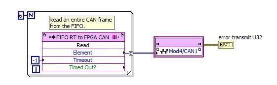

I would like to send data of type I16 with CAN. CAN only has data of U8.

And why does a CAN frame of NI have 192 bits, although the extendet format has 128 bits. How can this be compatible with other devices that receive these frames.
/edit: Now I understand the conversion of the data, I think in the picture. But the question of the frame length remains.I16U8I16.JPG

Also the typecast is an option. U8 array to I16 or I16 array for more values.
For the extra bits, does it include a timestamp?
Will you do some of it in FPGA?

I don't need a timestamp.
The module 9853 must be controlled via the FPGA.

Maybe something like this would do?
Skipped making the fifo, as i was lazy

What is more useful? Summarize the CAN frame in the host and send the frame to the FPGA.
Or send the signals to FPGA and put together the frame there?
(2,575 Views)
If you have space in the FPGA, do most there and align data in FIFO to be easy for the CPU.
If address is fixed or not changing fast ( let's say fast is 10 ms), only send I16 data over FIFO, and send it to CAN as it comes in from FIFO, or in chunks if more datagrams is needed. Does it makes sense?
