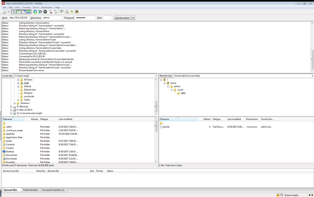

I tried on an VM and did a simple test to make sure I was able to see my files. Are you using sftp? Are all filters under Directory Listing Filters (in the "View" tab) disabled? (they should be by default, but just wanted to make sure).

Yes all filters are disabled, but even so remember I'm having the same issue when accessing these directories via Windows Explorer.  This is normal FTP (no port specified in Filezilla) and using the anonymous login.  Also notice that the directory I was trying to access was in a different path than the one you showed.  I had /home/lvuser/data/CAN Log not that I think that particular path is the issue, but rather likely something my LabVIEW program did to that directory.
