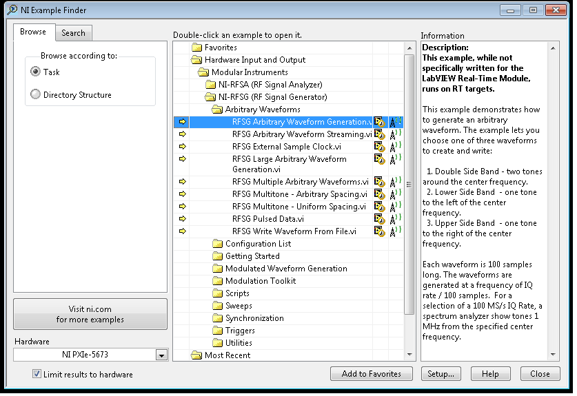

i want to input signal at 70MHz to NI 5450 to convert it from analog to digital then input it to NI 5611 to make upconverter for 70MHz to RF
but i want to update the memory of 5450 with my signal can you help me for this step using example

We have several LabVIEW examples that come with NI-RFSG driver. You can run the following example to generate and arbitrary waveform with 5450 and then upconvert it using 5611: RFSG Arb Waveform Genereation.VI. You can access Example Finder through LabVIEW Help ->> Find Examples
It looks like you have basic components of our VSG PXIe-5673 that consists of 5611, 5450 and 5652. Do you have 5652 or do you have your own local oscillator?

i do not want arbitary waveform which saved on the memory of 5450 but i want to input signal to the memory of 5450 to convert it to analog then upconvert it using 5611

It is not very clear what you want.  You may want to explain you goal better.
1) Have you looked at the shipping examples that Mikhail has displayed? Are they on your computer?
2) The example under the one highlighted in his image, "... Streaming.vi" has you load a waveform from a file and stream it to the generator on-the-fly. Thus you are not using data "saved on the memory of 5450". The waveform need not be from a file but can be created dynamically in software and streamed to the generator.
3) Do you also have a 5652 in your system? You can use the generator and upconverter drivers separately to try and achieve you goals, but this is probaly unecessary extra work.   If you have a 5652 as well, it means that combined, your modules make up a VSG, PXIe-5673, as Mikhail has explained.  This allows you to use the RFSG driver and examples that should make your job much easier.
