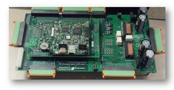

In this tutorial a new design of back-to-back power inverters is presented. The design involves the prototyping of power electronics circuitry developed in NI Multisim and NI Ultiboard as well as an FPGA-based digital controller developed in NI LabVIEW FPGA and targeted to the NI Single-Board RIO 9606 and the NI General Purpose Inverter Controller (GPIC).

The design topology contains two power inverters in back-to-back configuration to support the different application use-cases previously mentioned. A single FPGA-based controller is compiled on the sbRIO-9606 and the connectivity to the inverters is implemented through the NI GPIC. This section provides explanation of the circuitry in each of the blocks of the block diagram shown below.
Power Inverter Blocks
These sub-circuits include two 3-phase inverter chips and two bridge rectifiers. Each chip is a 6-pack intelligent power module (IPMs) with built in gate-drivers and thermistor temperature sensing from ST Microelectronics (STGIPS10K60A). The design includes all the recommended decoupling capacitance. Operation is tested with control loops up to 20kHz.
The board operation is rated at 50VDC and 8A of current and the DC link includes in-rush current control using a thermistor and a relay contactor controlled using the GPIC.
Also included in the design is on board current and voltage sensors for each half-bridge. The hall-effect sensors ASC712 from Allegro are used to sample the currents while the voltages are sampled using potential dividers. All the sensed signals range between +10V and -10V and are routed to the isolated simultaneous analog inputs of the GPIC.

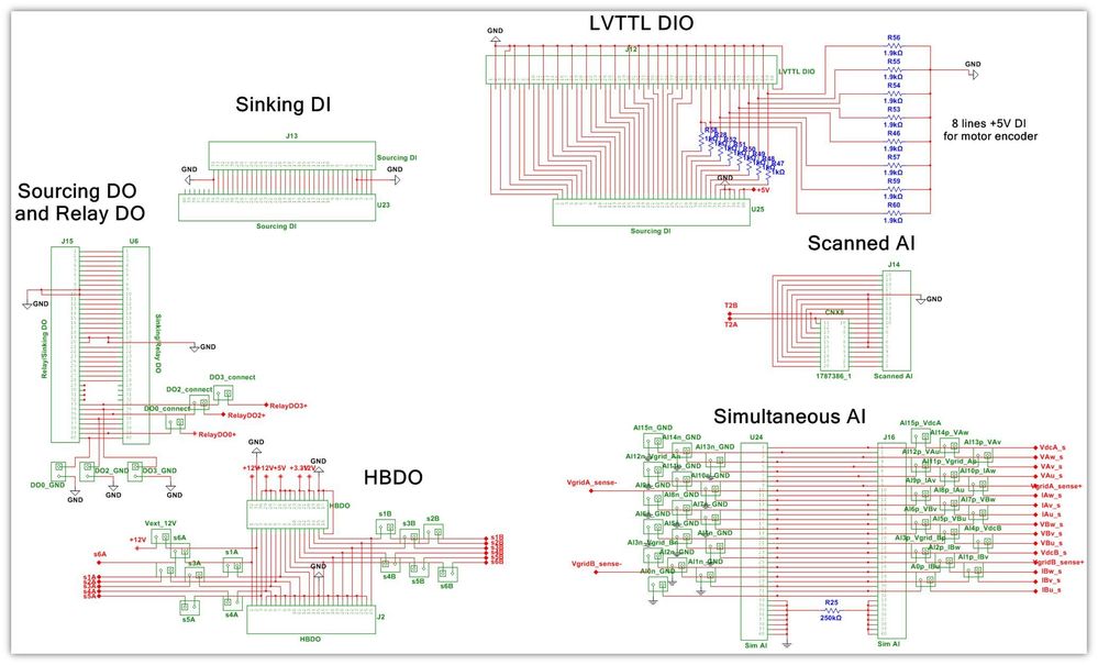

Signal Conditioning Blocks
These sub-circuits include the necessary electronics to maintain isolation between the controller digital section, and the inverter analog section of the design.
The switching command signals (S1A, S1B,  S2A, S2B…, S6A, S6B) coming from the GPIC are responsible for toggling the IGBTs inside the 6-pack IPM. These signals are first isolated using opto-couplers before getting to the power side.
All the current sensors are powered using an isolated buck converter supply (VBT1-S12-S12).
GPIC Connectivity
This sub-circuit includes the entire break-out connectors to the GPIC signals. Right-angled headers with pluggable terminal blocks from Phoenix connectors were chosen to make an easy wire-poke connection.
All the connections to the GPIC I/O pass through jumpers that have to be physically placed at the bottom of the board. This feature is helpful in case these I/O lines need to be used in some other way.
Also 8 of the +3.3V LVTTL DIO lines are connected to on-board potential dividers in case +5V digital input lines need to be connected to directly to the board (for example, signals from a motor speed encoder)
Power Supplies
Two supplies are needed to power up the board:
  1. -      24-pin +12V ATX power supply to power the digital ground section as well as the sbRIO
  2. -      +15V power supply to power the inverter chips

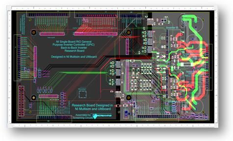

4. Ultiboard Layout
The analog plant circuitry is prototyped on a custom PCB in Ultiboard. The design maintains complete isolation between the high-power analog signals and the low power digital control signals. To do so, the board is comprised of three main sections:
  1. Digital control section with mating connectors to the GPIC and referenced to D-GND. This section contains the routing of the HBDO signals, break-out connectors for DIO lines, relay control digital lines, ATX-24pin power supply, opto-couplers and isolated buck converters to power up the inverter and the sensors at the analog side.
  2. Analog low-power section containing the feedback signals referenced to P-GND. This section contains the routing of the isolated sensed signals to be sent to the GPIC and it break-out connectors.
  3. Analog high-power section containing the grid inputs, the DC Link capacitors, and the 3-phase outputs of each inverter. It also contains circuitry of thermistors and relays to digitally control the in-rush current into the DC link capacitors.
