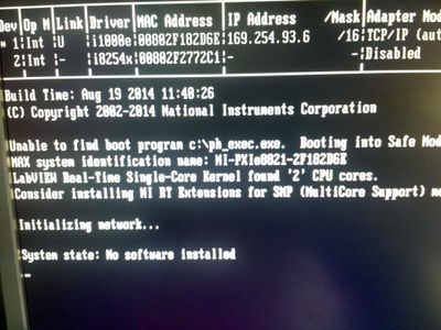

Hi
is it normal to see this message after i format my pxie? "Unable to find boot program c:\ph_exec.exe"
It goes away when I install all my software but then the PXIe reboots when i try to deploy something from Veristand.
I'm using a PXIe-8821.
And i'm trying to use software from 2015 (Veristand, and many other software from 2015 into the PXIe.
I formatted it maybe 1 month ago but I don't remember this problem. And there weree no (not wanted) reboots.
Thank you in advance.
Regards

Your error indicates that the pharlap.exe isn't present. Per my experience, the solution is to boot into safe mode before attempting software installation. Maybe this would help.

Thanks for your answer.
Yes this 'solves' that error message but it reboots anyway when I try to deploy my project. I tried with another project too and doesn't work either.
